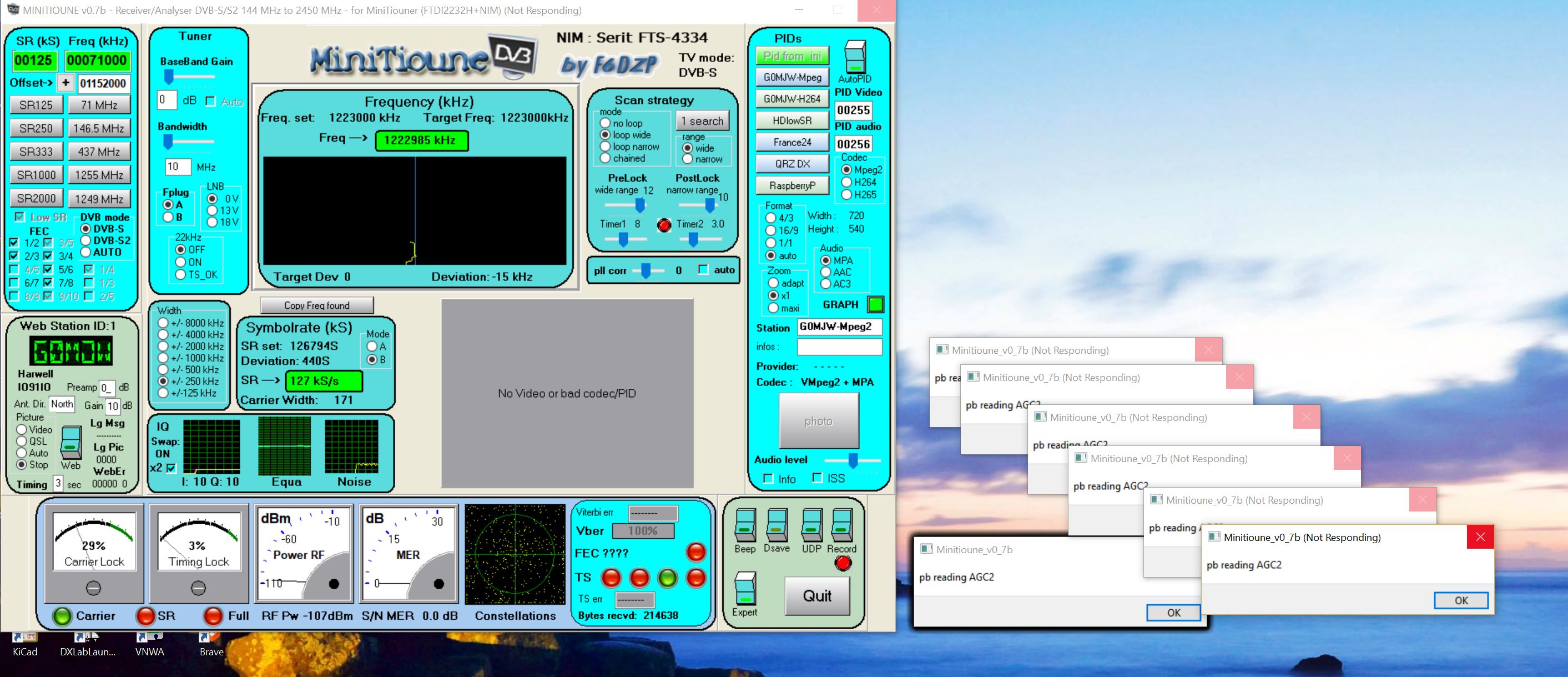

Could you also do something about trapping errors as I end up with a screen full of error windows at times, all asking me to press OK, when something goes wrong. Only option is task manager.

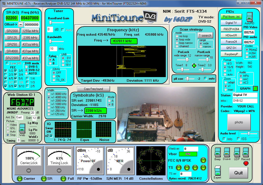

About the PLUTO, I have always the same strange clouds, even at SR2200: I have made other tests with Evariste thsi aftenoon, same result.
@ Mike
What is the NIM used? I know that a Sharp or Eardatek don't show with the same amplification these kind of anomalies.
So I have indicated that it is what I obtain using a FTS-4334.
It is difficult to fix if I have not a more complete description and screen capture.

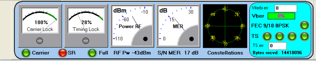

Jean-Pierre,
As far as the constellation is concerned it is difficult to tell what the issue is
but I know there is an issue because when I measure the EVM it is far worse
than Express. The Pluto specs indicate it should have a much better EVM/MER than
Express has. I am using EVM as that is what my Agilent test gear outputs.
The only difference between Express and Pluto is the raised cosine filters.
Originally I used an application on the internet to generate the filter coefficients
but the application is no longer available. Now I calculate the coefficients myself
using some maths I got from a NASA website. I suspect the issue may lie there.
When Evariste used my RRC code to generate a filter for the LimeSDR it did
not generate the correct filter shape.
However I would not expect to see the type of error that is showing up on the constellation.
Maybe the equaliser is trying to correct the error and that is masking what is actually happening.
- Charles

The modulation issue with the pluto looks quite similar to phase jitter or AM/PM. Could it be the phase noise or other noise? If you got rid of all filtering, the constellation should be perfect? Maybe looking at the constellation with and without filtering would help identify where this is coming from. Than again, does it matter? An MER of 36dB is like a titanium kettle. Somewhat over-specified for the task at hand.
Gnuradio has some filtering code that might be useful. Maybe I might also make my usual point about integer overflow, though I don't think its relevant this time.

I am using the Serit with the low noise amplifier. I have not tried my older sharp in a while but I may get it out to see if there is a difference.F6DZP wrote:Charles,
@ Mike
I suppose that it is when you are using Minitioune.Could you also do something about trapping errors as I end up with a screen full of error windows at times, all asking me to press OK, when something goes wrong. Only option is task manager.
Jean-Pierre F6DZP
Unfortunately the crashing locks up the PC. But what happens is a dialog box pops up saying something like "floating point division by zero" - like this but this is just a random image from google and not it.
http://community.pmail.com/forums/stora ... pmail1.jpg
Then another pops up on top of it slightly offset and before you know it the screen is completely full of them all overlapping. CTRL+ALT+DEL and killing the process is the only way to recover.
PS - something similar to this, which was achieved by cutting the power to the tuner - but with some other error causing it.
