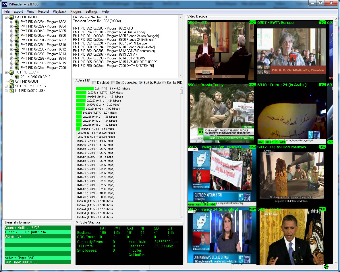

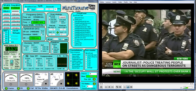

The last version of Minitioune can work also at very High SR.
here is an example at SR25000 TS rate is about 35 Mbps, Minitiouner and USB interface can run it . Consumption is 680 mA at this rate.
( max conso of 1.8A is done for DVB-S2 at 45 MS/s)
so for DVB-S at any SR, I think that the LP3879 will be sufficient.
Minitioune V0.1f_beta SR25000_.jpg (127.79 KiB) Viewed 7992 times
TSreader receiving the TS via UDP at same time than VLC show that there is no CRC errors no lost of SYNC...
yes the Minitiouner can work at high SR.

This last version of Minitioune ( v0.1f) will be available soon for download.
Jean-Pierre F6DZP
