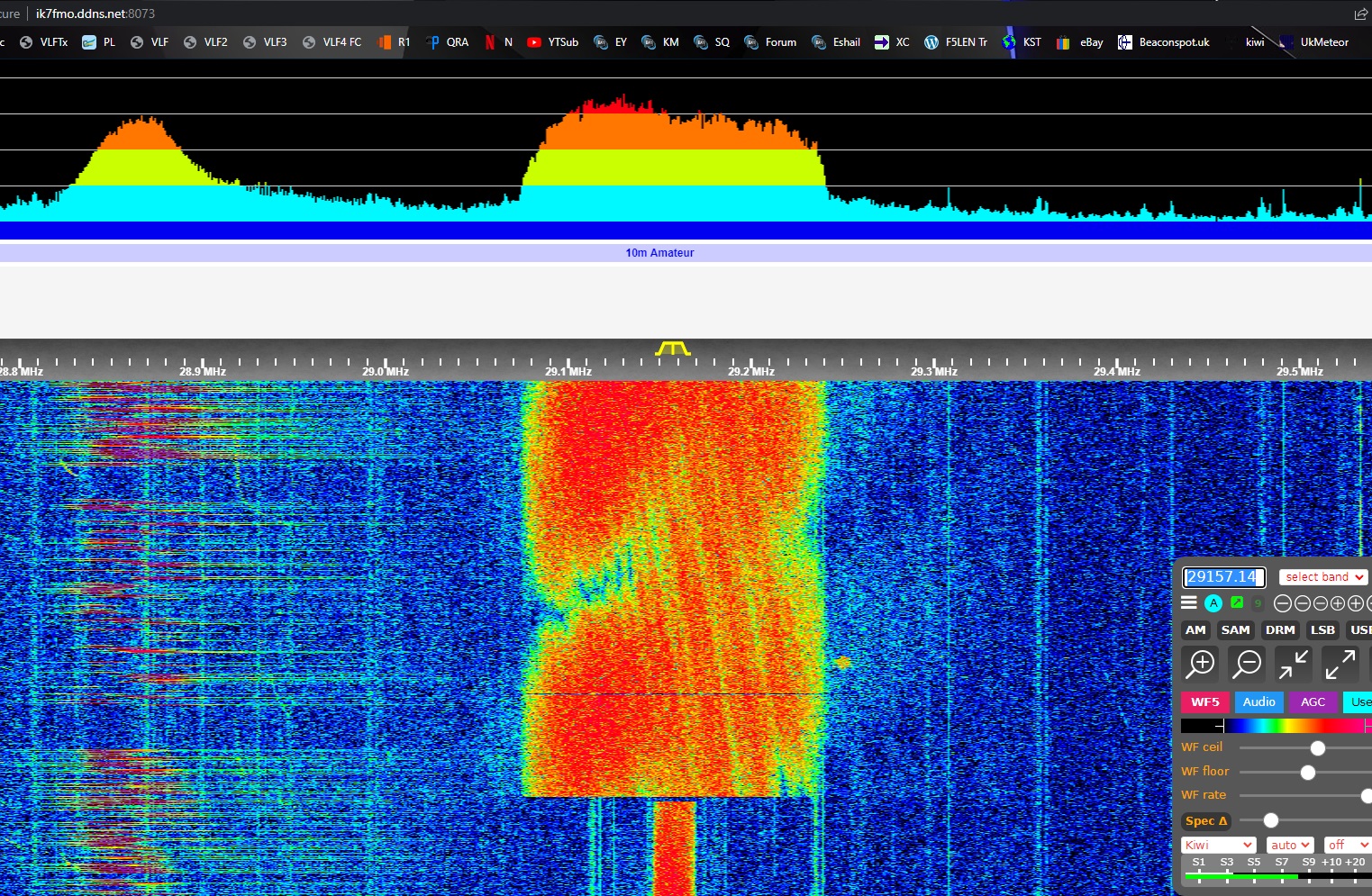

Ok, so 150Ks DVB-T may be good, I never got that to work in the past but ill try again.
Guess I'll have to do some videos on using SDRAngel then.
Here's a test from me on 125Ks DVB-S, look at the strength in Italy just now!!
