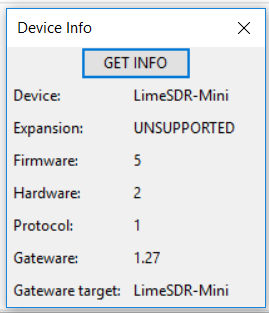

G4GUO
Posts: 736
Re: DATV-Express Project
Post by G4GUO » Sun Nov 11, 2018 10:10 pm
It is likely you need to update the Firmware / Gateware
I am currently running
Firmware 5
Hardware 1
Protocol 1
Gateware 1.26
https://wiki.myriadrf.org/LimeSDR_Firmware_Management
I have not tried that command from Windows.
I will think about adding a dialog to the Express program that displays the firmware version.
- Charles

F4HSL
Posts: 8
Joined: Sat Nov 10, 2018 3:02 pm
Post by F4HSL » Mon Nov 12, 2018 12:44 pm
Happy to know this upgrade has solved your issue. I have done the same thing. Latest firmware version now, but unfortunately same problems :(
