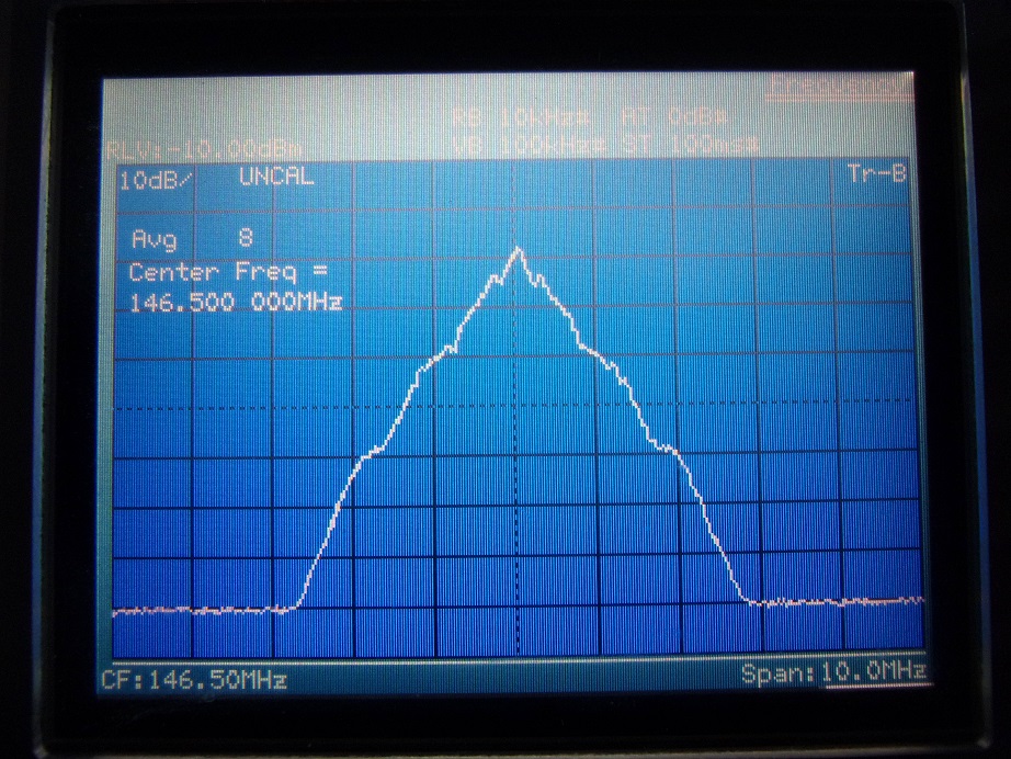

Talking with Charles this afternoon, there is a problem with DVB-S below 521k symbols in version 1.25p1 where it gets rather wide, so DVB-S2 only is advised for the moment.

Charles G4GUO has just made available early-experimental alpha-release v1.25p4 software that corrects the RB-DATV wide-spectrum-“haystack” bug with DVB-S protocol reported by Brian G4EWJ. G4GUO explains the problem was caused by “math overflow” into one of the PLUTO buffers. The v1.25p4 software has just been posted to the DOWNLOADS page of the http://www.DATV-Express.com website.
PLUTO-Express v1.25p4 software running SR=333KS/s RB-DATV with DVB-S and H.264
73...de Ken W6HHC

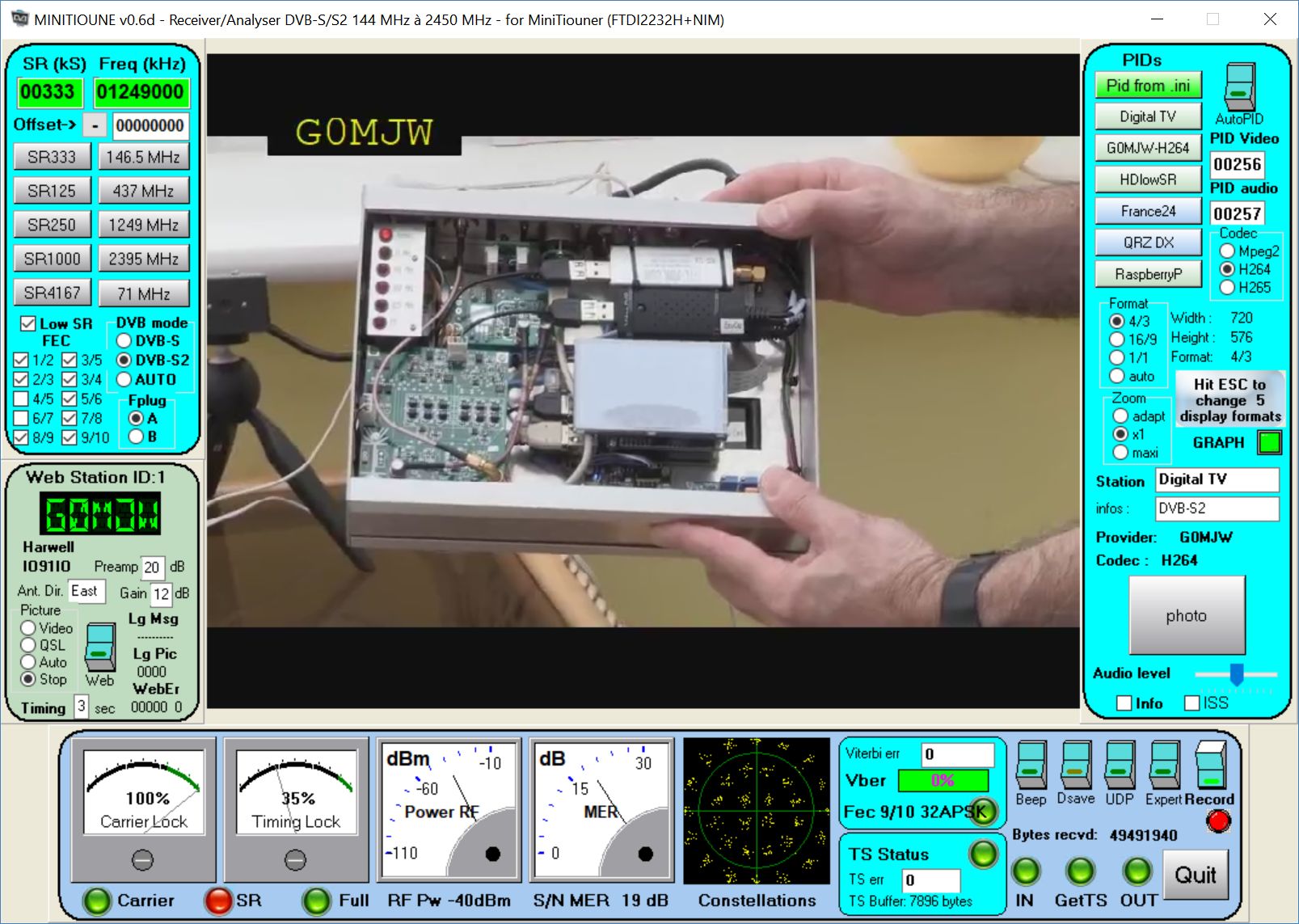

Just testing with 32APSK at 333ks again with Charles's latest software. Very good quality video at 1.2 Ms/s. The only reason it's not HD is because I am using the free version of Vmix which is limited to SD.
Pluto-MinitiouneV2 32 APSK 333Ks.jpg (276 KiB) Viewed 13518 times
Hoping to try this on 70MHz when I can find someone who can receive it.

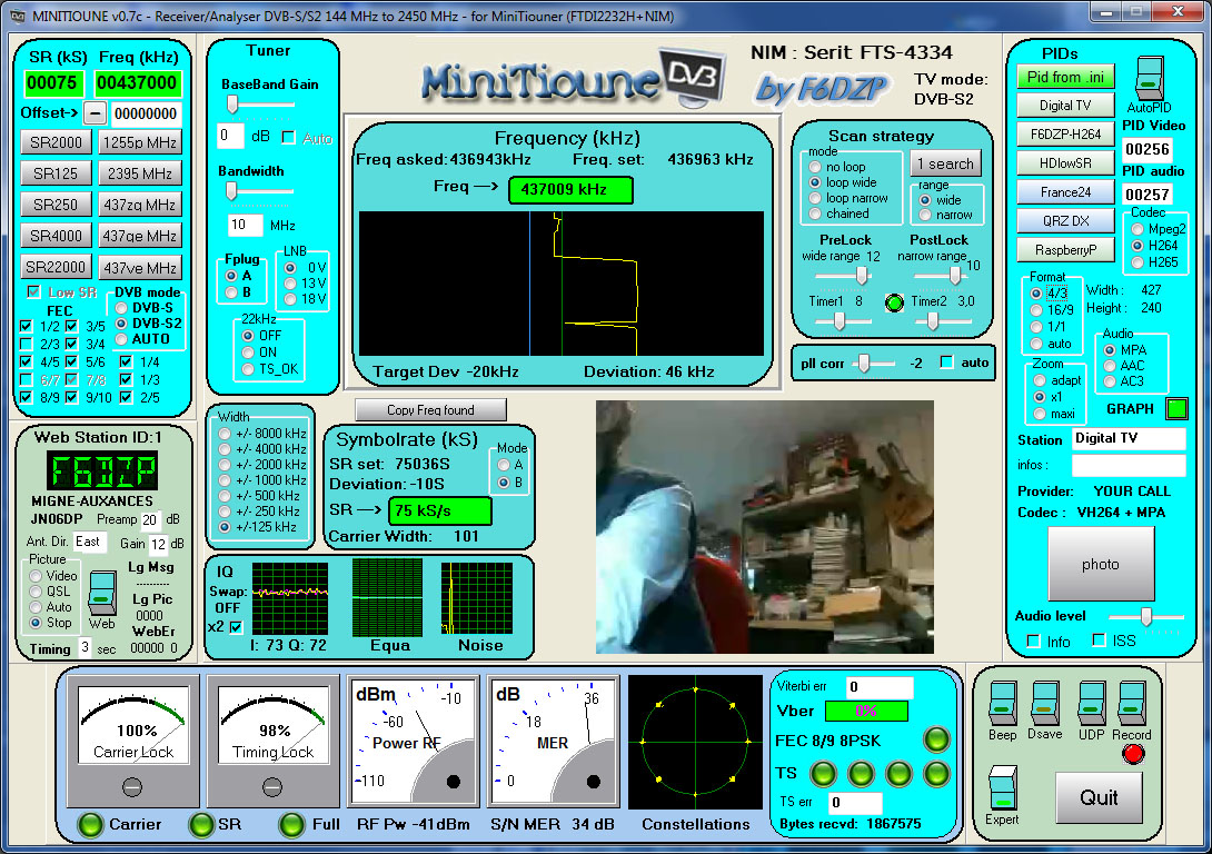

the Serit NIM FTS4334 is very sensitive to any noise, jitter, distorsion.. in the signal. ( more than a Sharp or Eardatek)
I have worked the last/next version of Minitioune v0.7c to allow a better sync to low SR and also direct receiving of 70cm or 146 MHz signal.
DatvExpress gives a very good result down to 146 Mhz and low SR (70 kS/s) concerning only the modulation:
- the only big problem with the use of DATVexpress is the very bad TS that is produced ( bad synchro, bad PCR, bad audio PTS, bad video PTS..),
but the analog signal is fantastic!
So, I only want to compare the DATV express analog signal and the PLUTO analog signal using the Serit NIM:
Using the DATVexpress, at 146MHz, or 437 MHz or 1255MHz , all SR tested between 70 kS/s and 4000 kS/s, MER is always betwwen 33 and 36 dB and look at the constellations, they show a signal free of noise or artefact. Superbe!

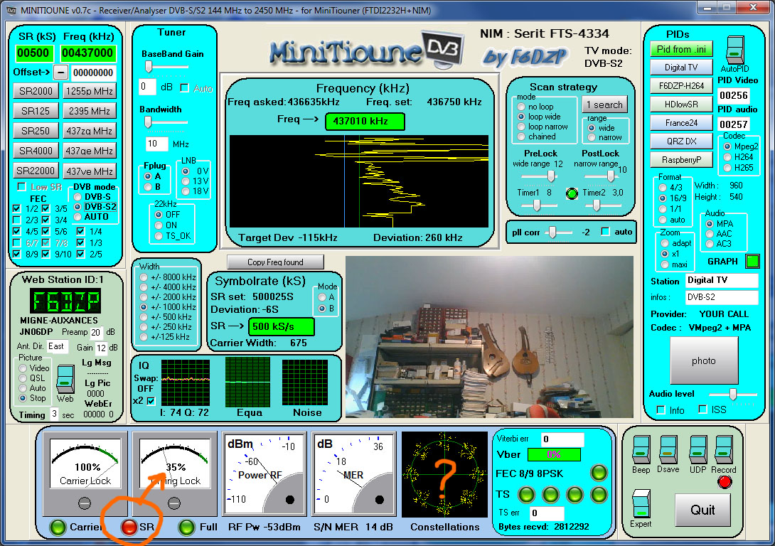

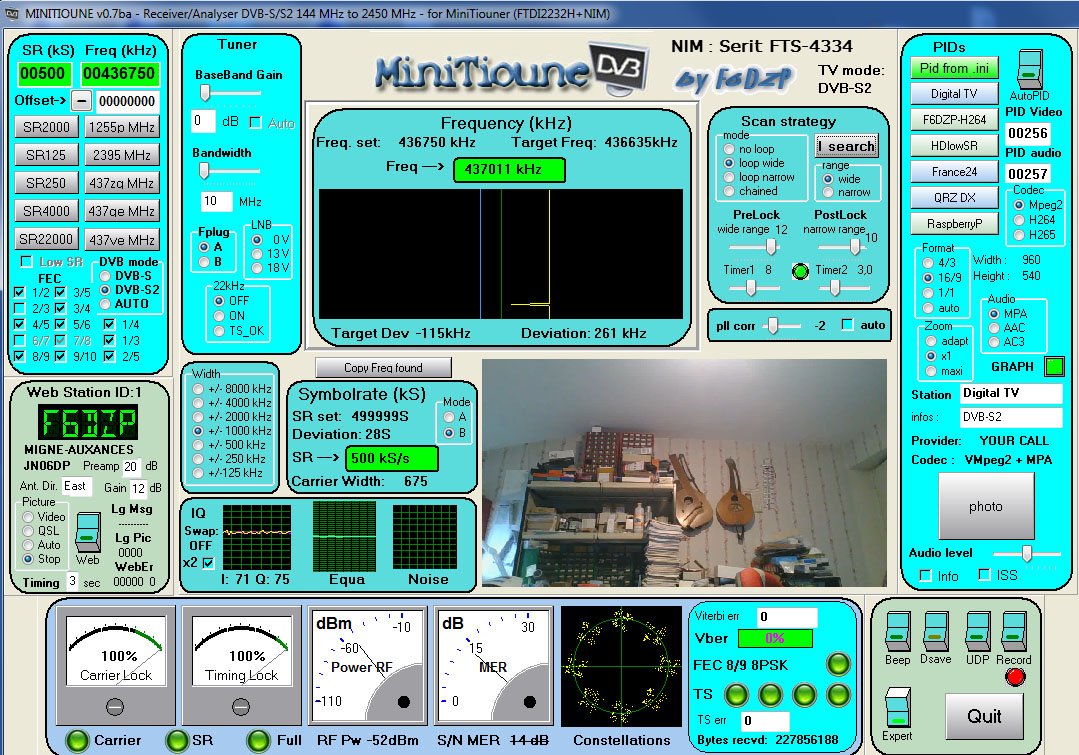

Using the PLUTO:
I can get a better synchro lock changing the Nyquist filter reference inside the demodulator, but the constellatiion/MER stay low quality:
So I think that there is something to improve in the PLUTO signal. ( each "cloud" is made of 4 little "clouds" )
Concerning Minitioune V0.7c (coming soon), result are better now than using a Sharp and direct reception of 437MHz or 146 MHz ( with preamp) now
has not less sensitivity than the use of a converter.
Jean-Pierre F6DZP
