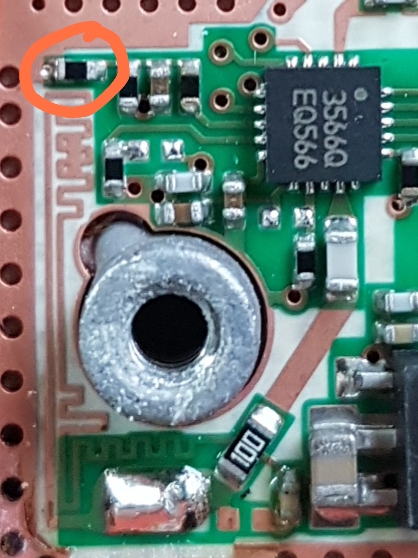

Got a second 27MHz dual Octogon LNB to mess with and based on a post M0EYT made to the ukmicrowave list I made the small modification to fix the output from the lower board to horizontal polarization on any input voltage. It should be handy for using both transponders without having to use 18v or twist the LNB to get horizontal.
The board/chip was a bit different to the 25MHz one pictured in the post but it has the same voltage divider arrangement on both sides and removing the 8.25k resistor works to set the voltage to the sense pin high to use horizontal. It seems to work fine and receiving BADR-4 using 12v from the Minitiouner on that output without twisting the LNB 90 degrees as I was having to do before.
It does mean I'm going to have to get 27MHz in via another cable rather than abusing the lower boards input as did with the other LNB. I might leave the wide band horizontal fixed board as is and just feed 27MHz to the top one for narrow band use if I can't figure out a non messy way to feed both.

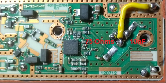

Reading up on the Forum and other sources, decided to get stability from inside the shack and fully tuneable as far as possible.
Andy G4JNT's write-up and pictures http://g4jnt.com/OctagonExtLo.pdf
Basically the same as Andy's, but isolating the "F" socket in the top RH corner to feed L.O. from the shack, making one of the twin redundant.
Mine looks a little different attaching R and C to Xtal land, also slot in top casting to let the yellow wire through
I have another LNB to try, L.O up and I.F down with one cable as per Mike G0MJW Mods.

P.S The PCB pulled away with Xtal, like they do, but managed to glue them before they came off completely

I know what you mean about removing the crystal. It needs two soldering irons, skill and patience to do it without damaging the pads. Even then it's likely to bring the pads with it.
Looking at that LNB I can see what looks like two 0R resistors coupling the crystal to the chip. It might be easier to remove one of those rather than the crystal. There are quite a few 0 resistors. Perhaps remove both and replace one with the DC blocking cap. They look like 0402 size.
