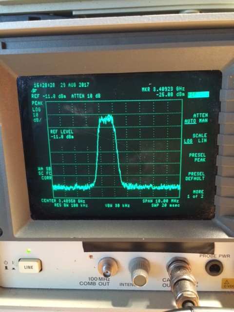

It could be the 3rd harmonic of the LO mixing with the baseband signal.
I would have thought that might also be overlaid with the 3rd harmonic of
the PA stage.
It would be interesting to see what it looks like on a spectrum analyser.
- Charles
P.S I just set mine to 2 MS/s 1 GHz and then looked at the 3 GHz component
the 3 GHz component is definitely 2 MS/s with an EVM/MER as good as the
fundamental component so I speculate that 10 GHz is the same.
Post by g8gtz » Tue Aug 29, 2017 4:48 pm
Quick test shows 2MS at 3.4 GHz

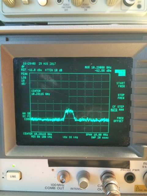

It's there but not very loud at 10 GHz

That's interesting. What do you get at 5.7 GHz x2 ? Could this spurious signal be filtered and amplified perhaps? Do we now have a 6m to 3cm DATV exciter for £92?
I speculate its a harmonic mixer type effect rather than a third harmonic. Need to be careful not to overload the mixer in the spectrum analyser when checking. A high pass filter (e.g. length of waveguide) would sort that out.

I would expect to see some combination of harmonics of the modulated output and modulation of the LO harmonic. It would be interesting to see the 10GHz signal at 60dB down.
