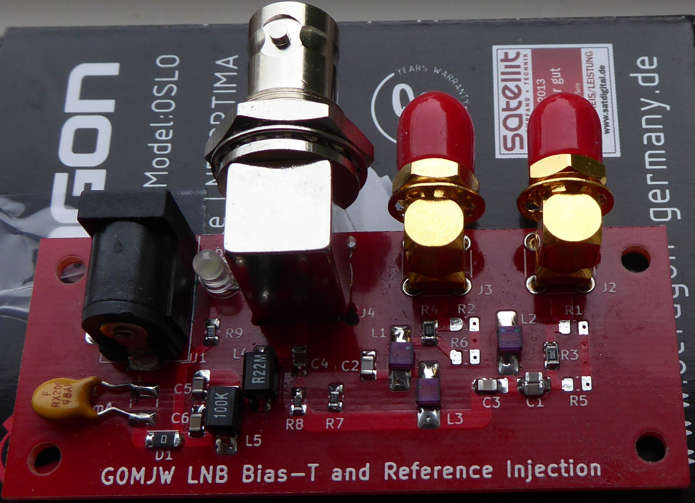

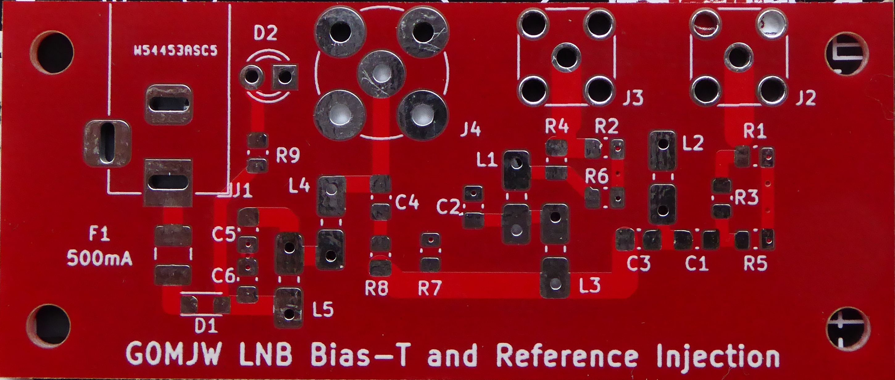

My boards turned up from PCB Way much quicker than I expected.
I have built one up, I haven't got all the right parts so a little bodging was needed, especially around the BNC/F connector, but it seems to be working. Needs cleaning up a bit. I will design an update based on what I have learned building the prototype. What to do next, not sure.

I would be interested in a couple of the next version Mike.

Thank you Mike for view of your circuit and new board, intrested in a couple of boards if they come available.
Also Brian for link, that's the one
and your information on modifications and limits.
