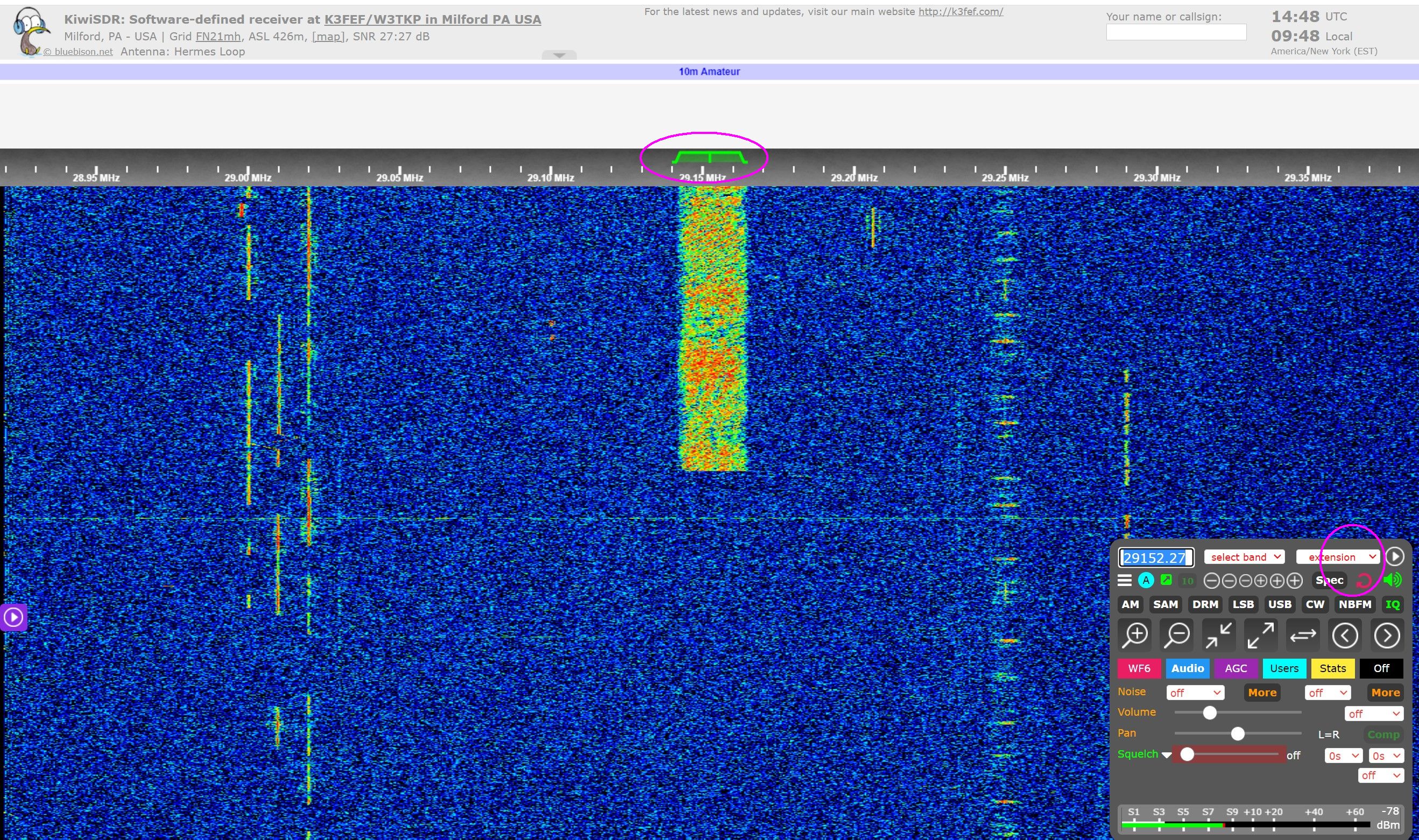

Rob,
I copied you on your local WebSDR yesterday, but I could not get SDRangel to make anything of the recording. However, I could only get the kiwiSDR to give me 12kHz bandwidth which is not enough. (It looks as if Mike was getting 20kHz which was the figure you mentioned earlier.)
Bandwidth probably would probably stop it working, or maybe something else which I have overlooked. Anyway, a report of failure but at least you know someone else is following your work with interest!

You need to pull out the bandwidth in the filter by dragging the edges and also you select record on the web page and it will download a Wav file.
- Clipboard01.jpg (1.2 MiB) Viewed 7510 times
Yes, thanks Mike, I got that far, but having looked at a few of the SDRs now, I think some go to 20.25k but some seem to restrict BW to 12k.

Nice to know others are interested Ken
Yes, unfortunately most only go to 12KHz of bandwidth which is a shame.
I just got lucky with the K3FEF kiwisdr which has good 10m sensitivity.
EW/KO33SV kiwisdr has 20KHz too but I've not got to that one yet.
