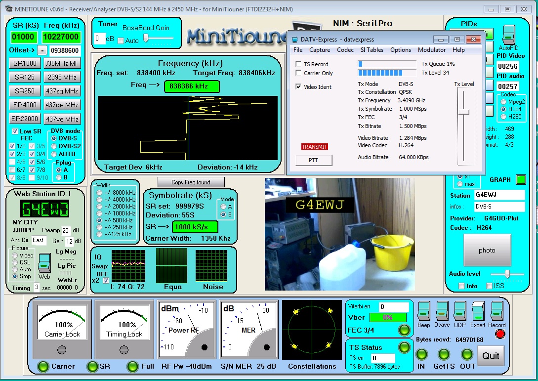

It's working at 5665MHz, SR1000, DVB-S, H264 as a lash up. The ADF4351 provides an LO of 4000MHz to the receive mixer. I can't get the constellation as good with DVB-S2. SR1000 looks like an optimum symbol rate.
Talking with G4CBW, he recommends 5763MHz for RB-TV, for people using narrowband transverters.

Great, Brian that is a better constellation than I have managed to get.
There are literally hundreds of registers to program in the AD9363
so I am sure things will improve when I get more familiar with it.
