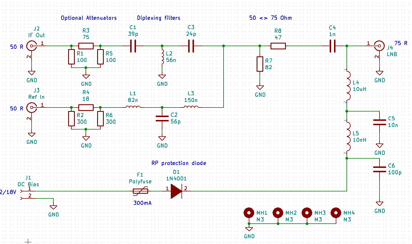

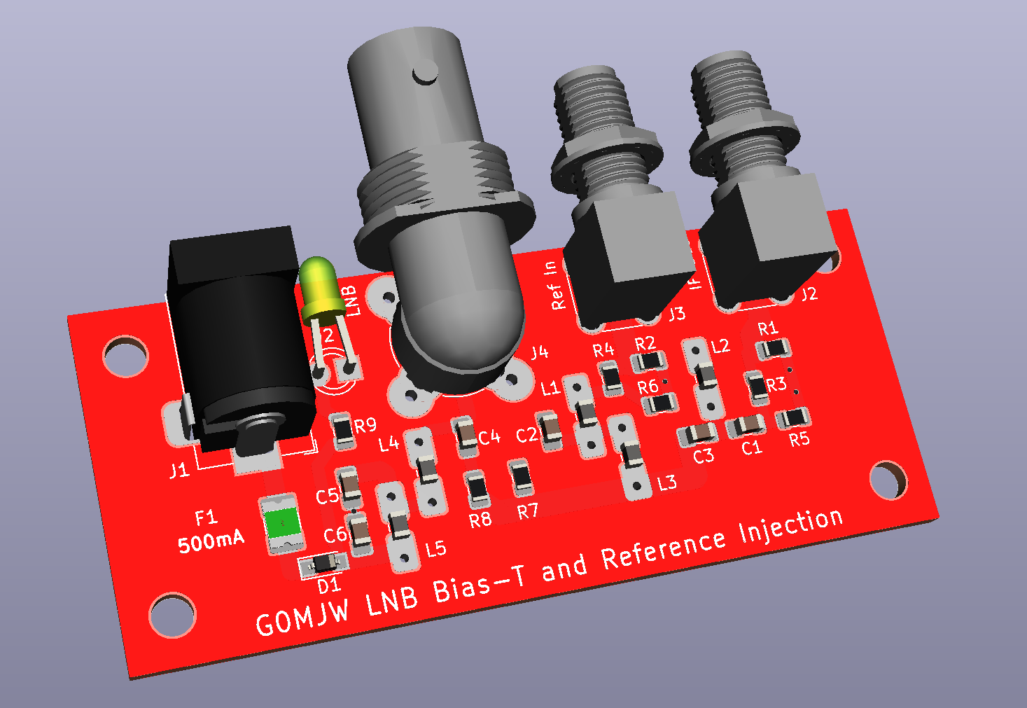

Wondering if this sort of thing is likely to be any use - should I get some PCBs made up? Before anyone points it out, I couldn't get the right 3D model for the 90 degree panel mount BNC/F connector and I have not even analysed it yet to see if the design makes any sense.
The idea is to inject 10/25/27 MHz and 12V DC to the LNB and get back the IF, all on one cable. At the LNB end, filter off the 10/25/27 MHz and use it to lock the PLL. I have several surplus PLL LNBs that do this already, all with 10MHz references.

I had similar ideas to this but didn't get round to it yet, very interested here Mike.
Allows us to use just two cables from the shack to lnb, one for datv and one for voice.
