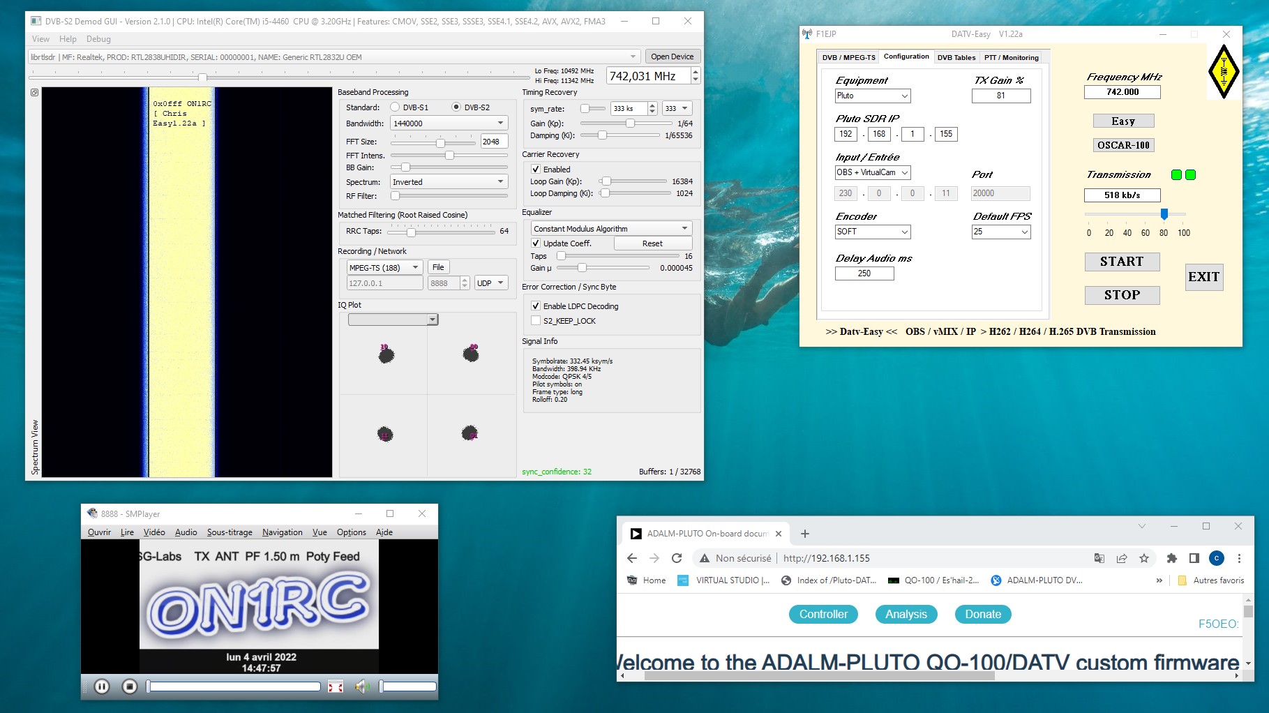

Post by ON1RC » Fri Apr 08, 2022 10:50 am
It works for me ....... :)
73 from ON1RC
Chris
Thanks Dominique ...
