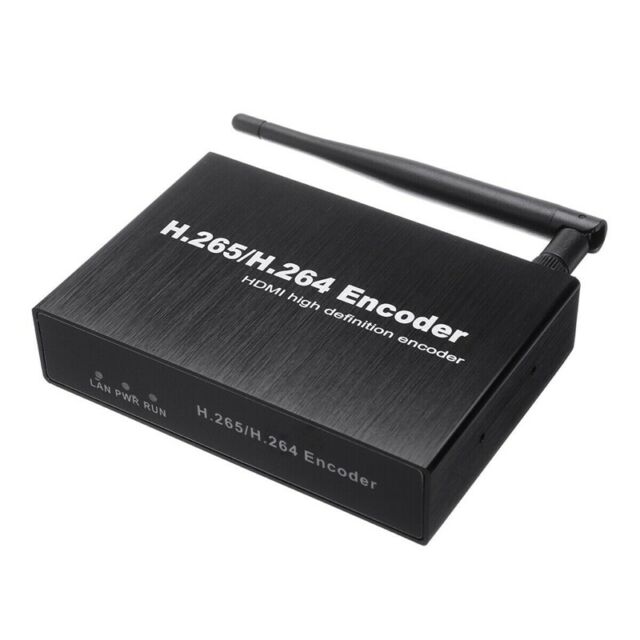

If it is a recent Pluto firmware check the box force compliant... on the Pluto control web page. Pulsing on and off implies UDP packet loss. I have had trouble with it too. Make sure WiFi is not involved anywhere.
- s-l640.jpg (27.21 KiB) Viewed 7488 times
