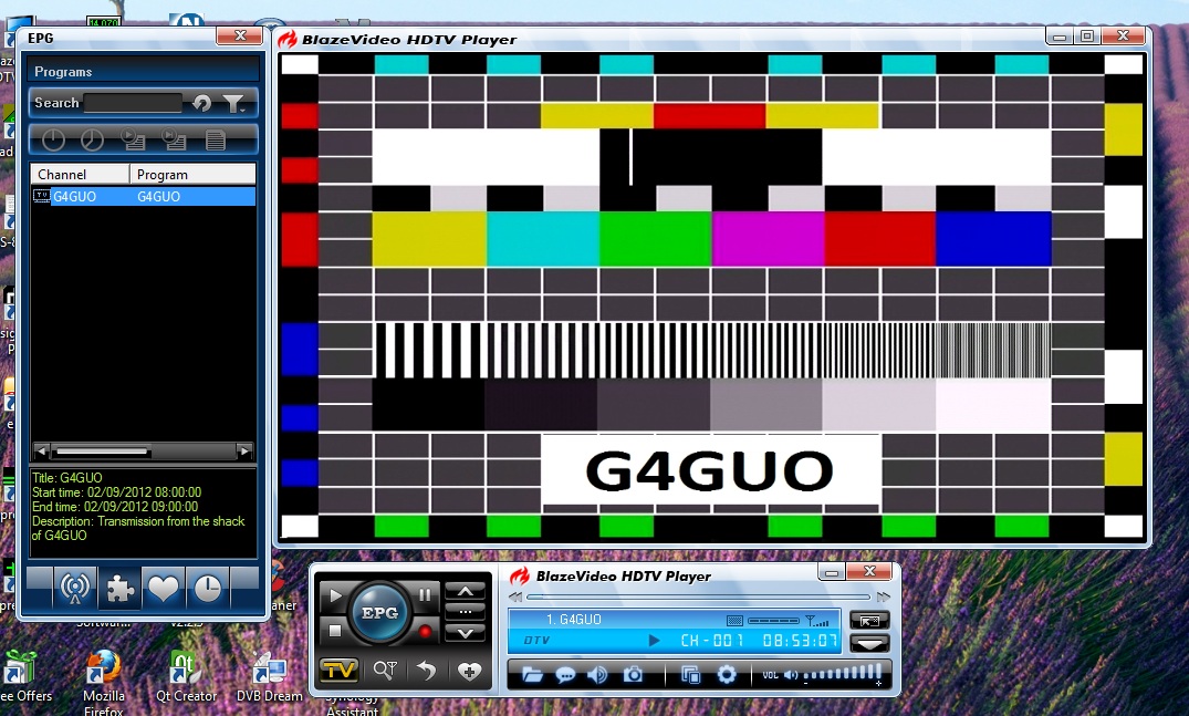

I have been playing with HD today. I am using a PVR-HD
to generate the video and audio. It works OK but I had
to re-scan the channel to get Blaze to figure out it
was getting H.264 instead of MPEG2. My Atom PC
is a bit slow decoding HD
http://2.bp.blogspot.com/-r-Kgu3GVxeA/U ... t_test.jpg
My program is even showing up in the EPG
- Charles
