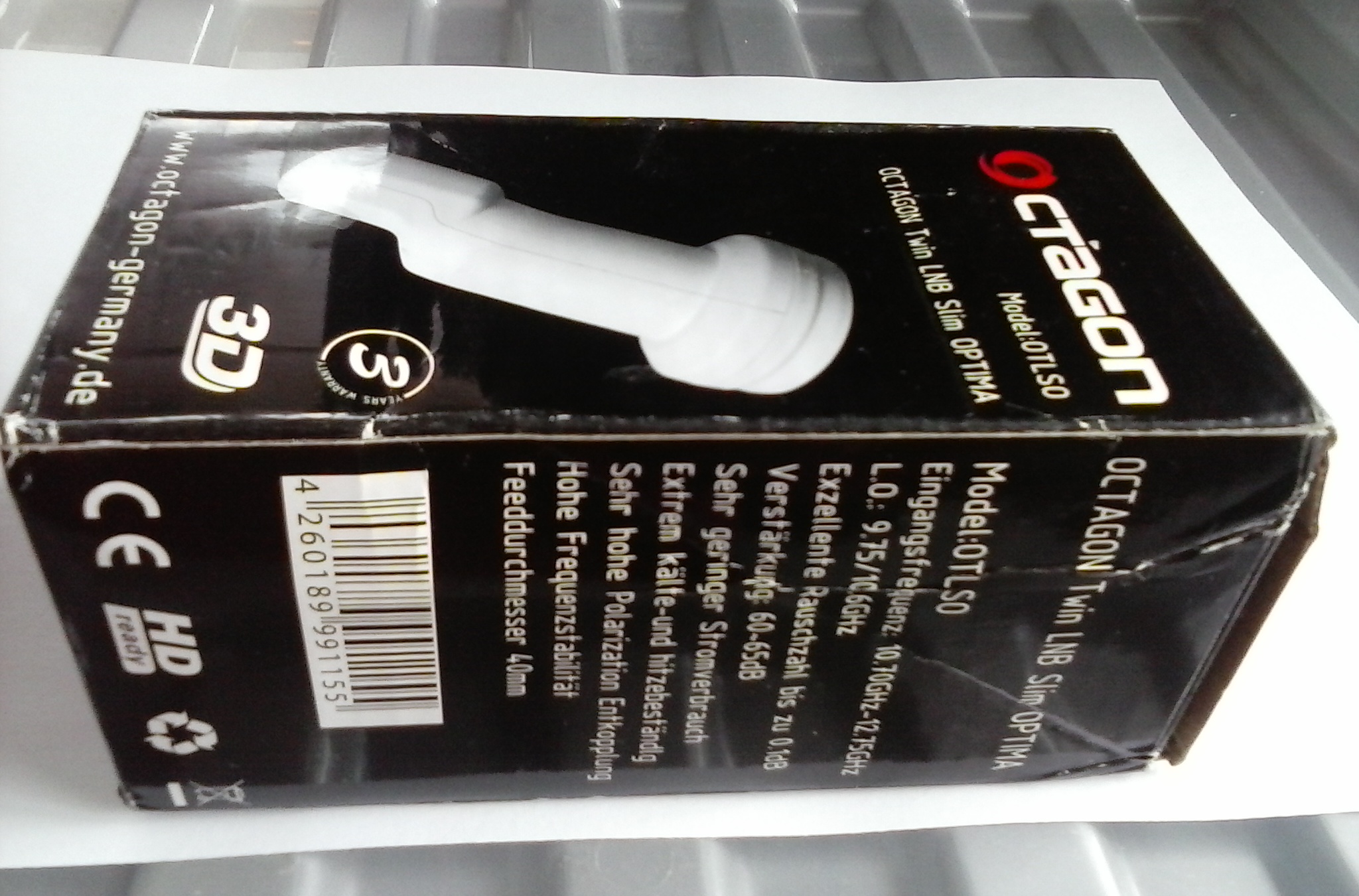

I bought one and it has the barcode 4260189991131 which the original information suggested a single PLL LNB.
The information I got from the web site of Octagon-Germany suggests no PLL and so I assume it must the DRO version. If no one has any further advice I must assume the manufacturer/distributor is correct.
Apart from cracking it open, is there any good way to tell which is which?

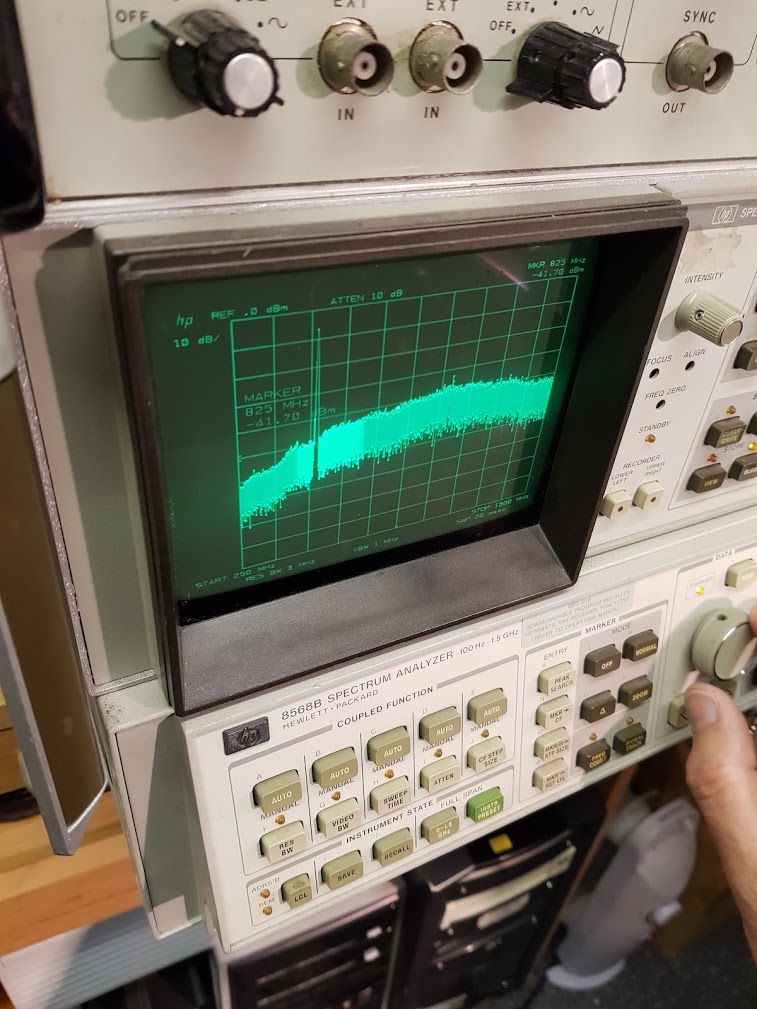

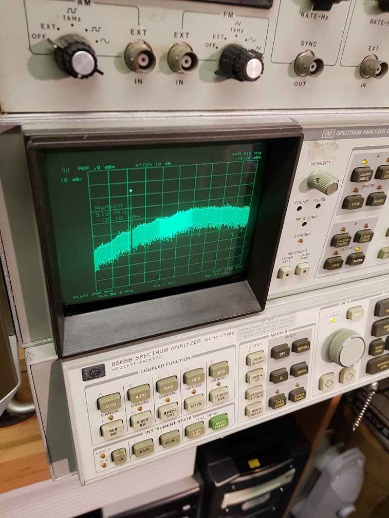

I bought 2 "Goobay" LNB's, done a sweep on a SA and they look pretty good for 10GHz frequencies, 250MHz-1.5GHz range on the SA display, looking at a 10GHz signal (10.250). First picture the marker wasn't on the signal.
These have a 25MHz Crystal, might buy a couple more and mod them,
