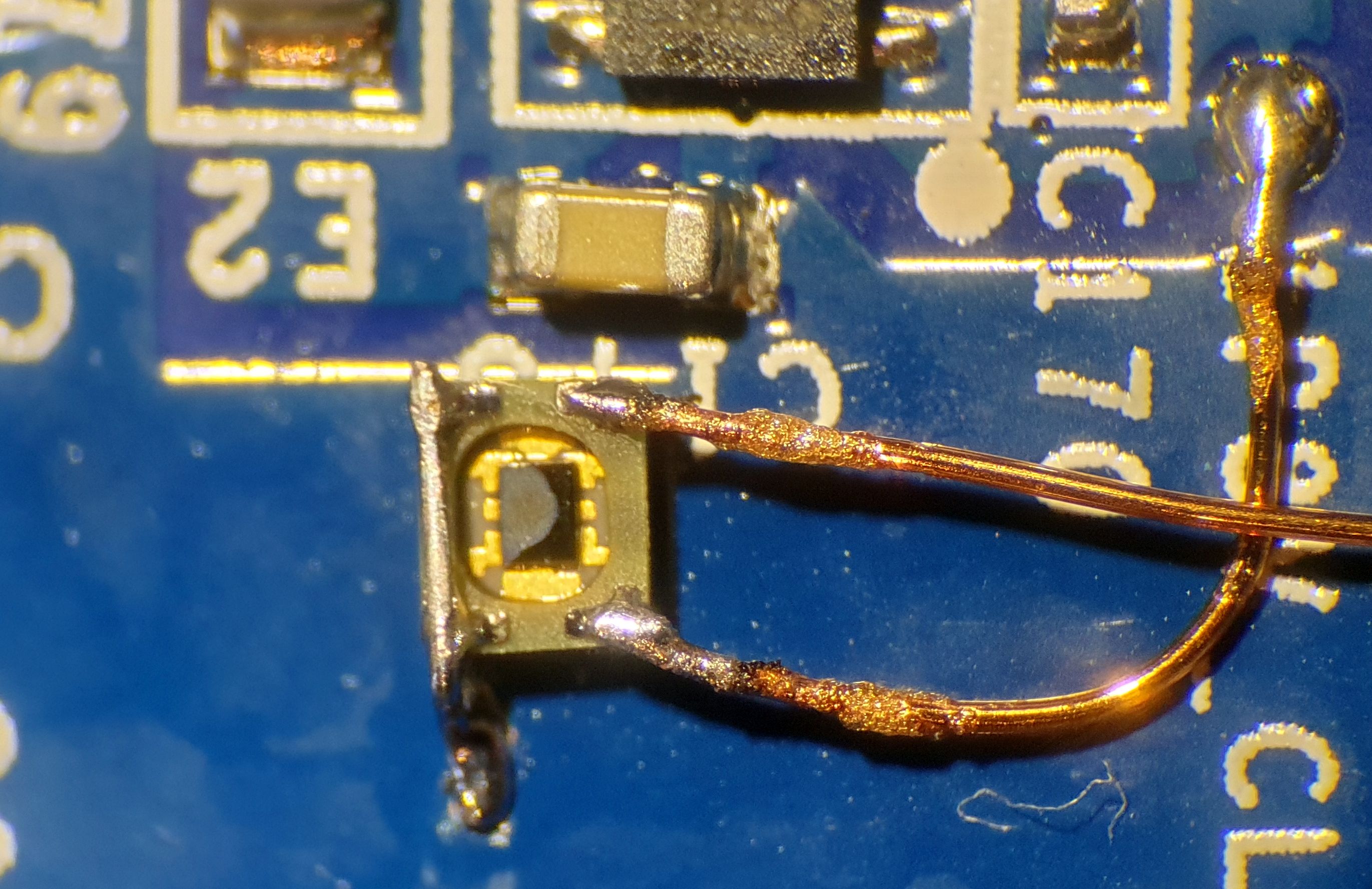

Post by m0eyt » Wed Oct 23, 2019 2:16 pm
Hi all,
I removed the original TCXO in my pluto my firstly kaptoning up the stuff around the LO, then using a hot-air rework gun set at about 300C to heat the area, followed by tinning the top of the TCXO with a soldering iron, this melts all the solder and you can just push it to one side, then wick the pads clean etc. I mounted by new LO away from the original spot as there were reports of localised board heating there. I used 0.35mm ECW for the connections as per the pic below;

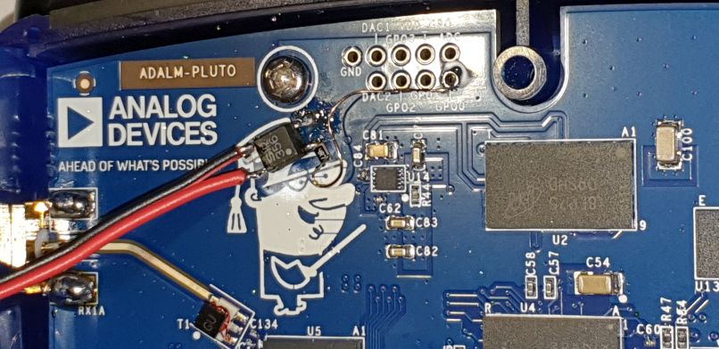

BTW on the DATV topic, a new firmware has been released to beta- testers which now supports GPIO PTT keying output when an input RTMP stream is present.
I've added an opto + 4r7, the opto output controls the PTT stuff on the PA's and works perfectly.
regards,
