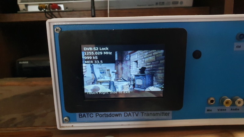

- 20191015_120511_resized.jpg (92.79 KiB) Viewed 23462 times
Hi Dave, glad you have the pluto working for DATV, the constellation it outputs is particularly good! If you need some words on OBS setup re bitrates etc let me know and I'll help you.
regards,
Paul EYT.
regards,
Paul EYT.
