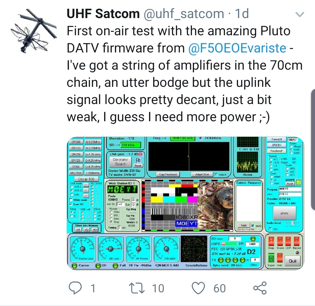

Just spotted this on Twitter, it seems there may be hope for those of us with a Pluto yet? Not sure of the background to the tweet but looks interesting.
- Screenshot_20191001-212846_Twitter.jpg (540.76 KiB) Viewed 29530 times
Yes, it works. Evariste has surpassed himself again. Just flash the new firmware and send your Pluto RTMP, which may require a fight with Windows network settings.

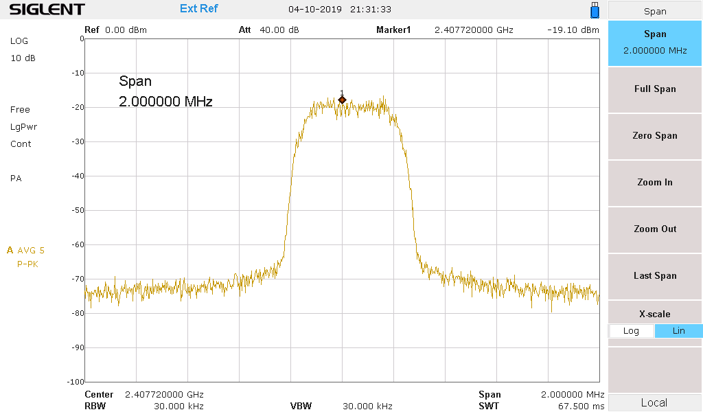

Evening all,
Yep that's my twitter post 2 above this, the pluto is working really nicely on QPSK/8PSK and 16APSK. As Mike says you just shove an RTMP stream at the unit over IP and out comes RF.
In my config in the VMIX software I have;
URL : rtmp://1.2.3.4:7272/,437,DVBS2,16APSK,333,12,
Pass : ,M0EYT,
The parameters are fairly obvious, and should be in exactly the format described above. The only think I needed to tweak in VMIX was the video output setting so it basically matches the symbol rate, else overflows start to appear.
With the pluto the RF output on 2.4G is fairly low, I think from memory I measured -18dBm average with a 333Ksps QPSK, an old Avantek gain block takes this up to 20mW then another amp up to a watt where its fed to a PE1RKI amp for about 22watts at the feed, easily enough to get 333Ksps QPSK up to the satellite with a 1.2m offset dish. Now the setup runs on the bench, I'll put a USB <> Ethernet adapter onto the Pluto, and build PA/SDR etc into my outdoor unit along with WB/NB source switching.
Pic above shows the nice clean QPSK generated by the pluto.
Hope to see you on the w/b transponder,
regards,
Paul M0EYT.
