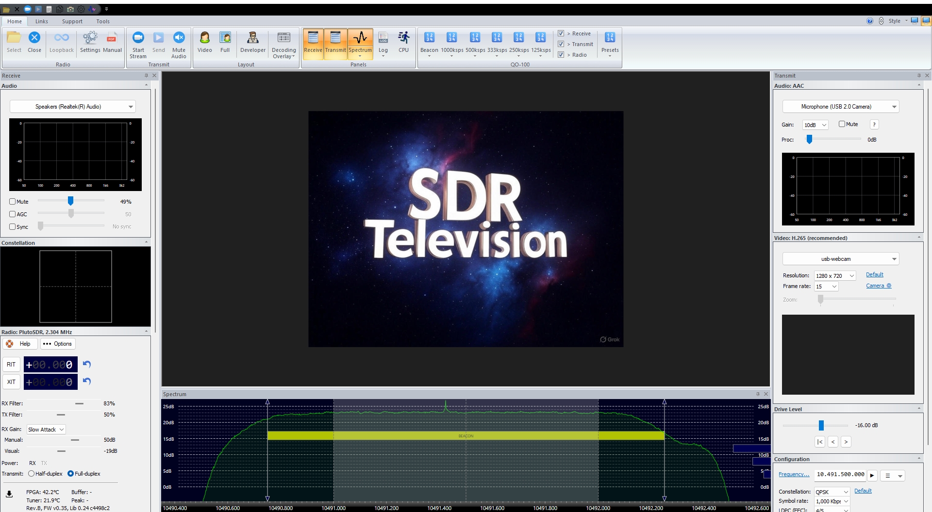

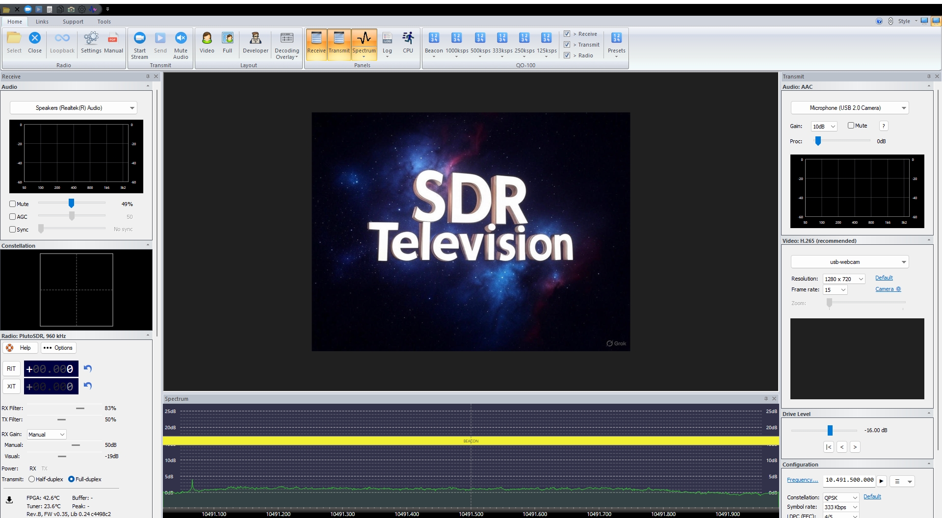

g0mjw wrote:
Sat Apr 26, 2025 8:40 am
Of SDR Television when running - there is a screenshot icon top left.
Screenshots attached Mike
Tony
SDR TV Running
SDR TV Running
SDR TV Running
SDR TV Running
Posts: 2735
Re: SDR Television
Post by g0mjw » Sat Apr 26, 2025 6:12 pm
Looks like you are tuned to the beacon with a 960kS sample rate, which won't work. Try 2.304 MHz.
You have the gain set to manual rather than automatic
Fix those and try again.

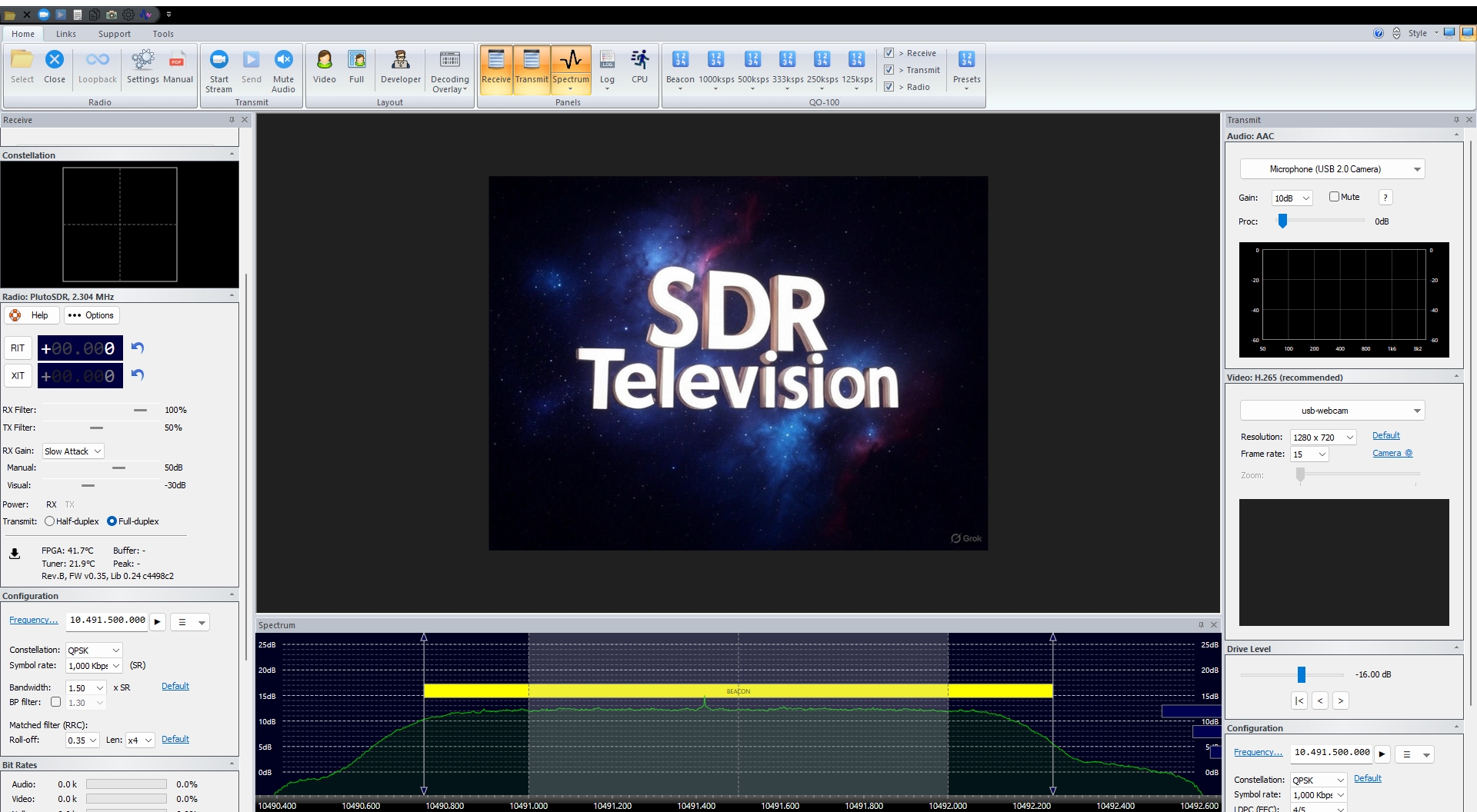

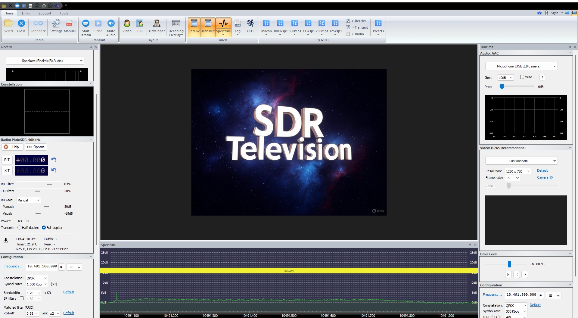

Post by g3uis » Sun Apr 27, 2025 9:47 am
Looks different, but nothing decoded and nothing in the constellation window ?
Tony
Latest
Latest
Posts: 2735
Re: SDR Television
Post by g0mjw » Sun Apr 27, 2025 10:40 am
Can you scroll down the receive pane. you are not showing us all the settings. It looks to me like you have a strange setting for RX bandwidth. Why have you set it to 83%>
Remember, please try to give as much information as possible, log files etc.

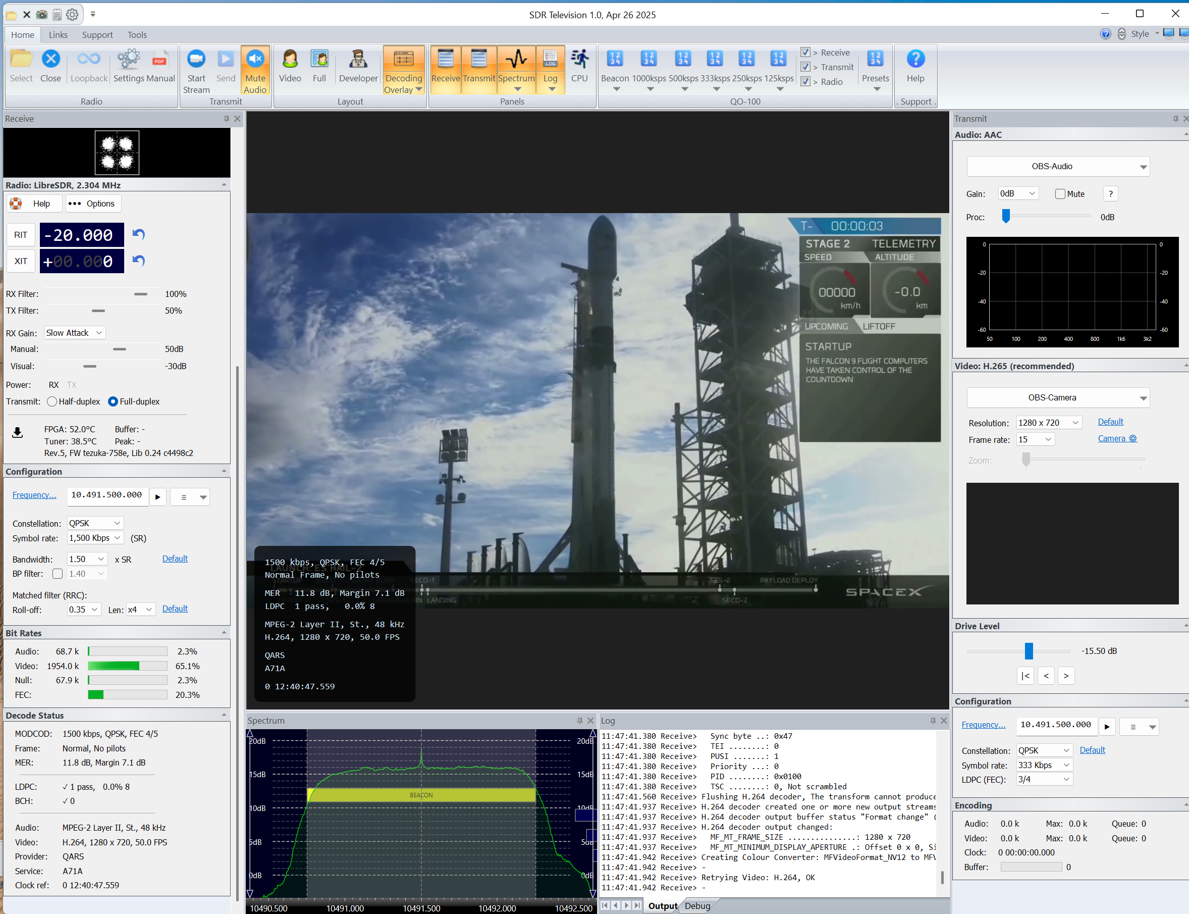

g3uis
Posts: 50
Joined: Tue Oct 18, 2022 10:30 am
Re: SDR Television
Post by g3uis » Sun Apr 27, 2025 1:34 pm
Thanks so much Mike
I've set everything RX wise the same as your screen shot. Also now attached the log from this session and another screenshot.
thanks
Tony
Log.zip
Logs
(11.32 KiB) Downloaded 246 times
Screen Shot
Screen Shot
Posts: 2735
Re: SDR Television
Post by g0mjw » Sun Apr 27, 2025 2:49 pm
You have a SR of 1000 set but the beacon is 1500
