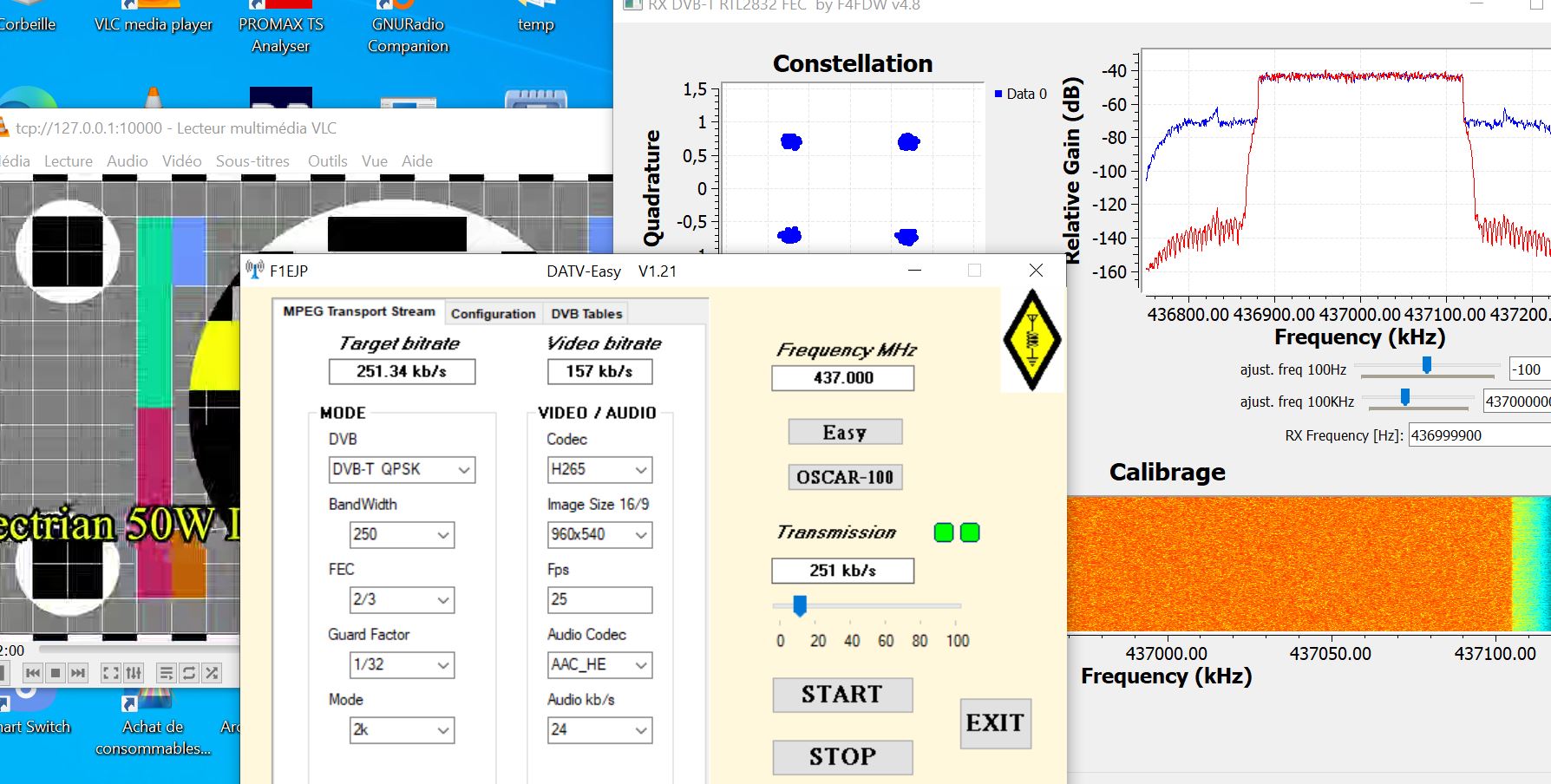

Post by F1EJP » Mon Mar 14, 2022 11:39 pm
New version now >> seem ok in DVBT all parameters
Send new link to beta testers
