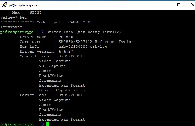

If you have an easycap, I know that there is a bug in mpeg-2 (not use the right camera). If it is the case and to be sure it is the issue : remove easycap from your raspberry and reboot then try mpeg-2. Let me know if it works.
arthur21
Posts: 64
Joined: Fri Sep 02, 2016 9:04 am
Re: 2MS DATV from Raspberry Pi
Post by arthur21 » Fri Oct 28, 2016 4:56 pm
Hi Evariste
Yes that's fixed it. With the EayCap removed the CAMMPEG-2 now works OK.

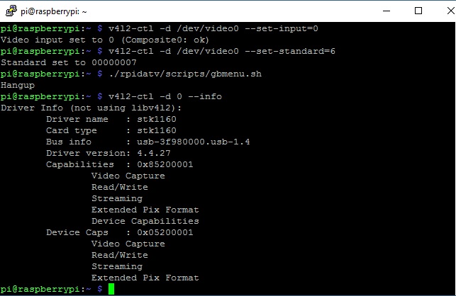

Effectively, easycap is a generic name for usb video capturer.
Mine is based on stk1160 and was buy 2 years ago on a chinese website. Don't remember the link.
Could be very interesting to have feedback about other users :
Please provide the result of
v4l2-ctl -d 0 --info
Where you buy easycap (ebay,amazon,aliexpress...)
If it works well with rpidatv .
Thus we could have a reliable source to buy these cheap dongles.

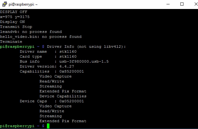

This is the info from my EZcap's
The first looks like yours and came from ebay a few years ago.
The second is a genuine one from Amazon six months ago, it is silver and has the USB on a flying lead.
I haven't had either working yet, but am looking in to that now.
G4KLB

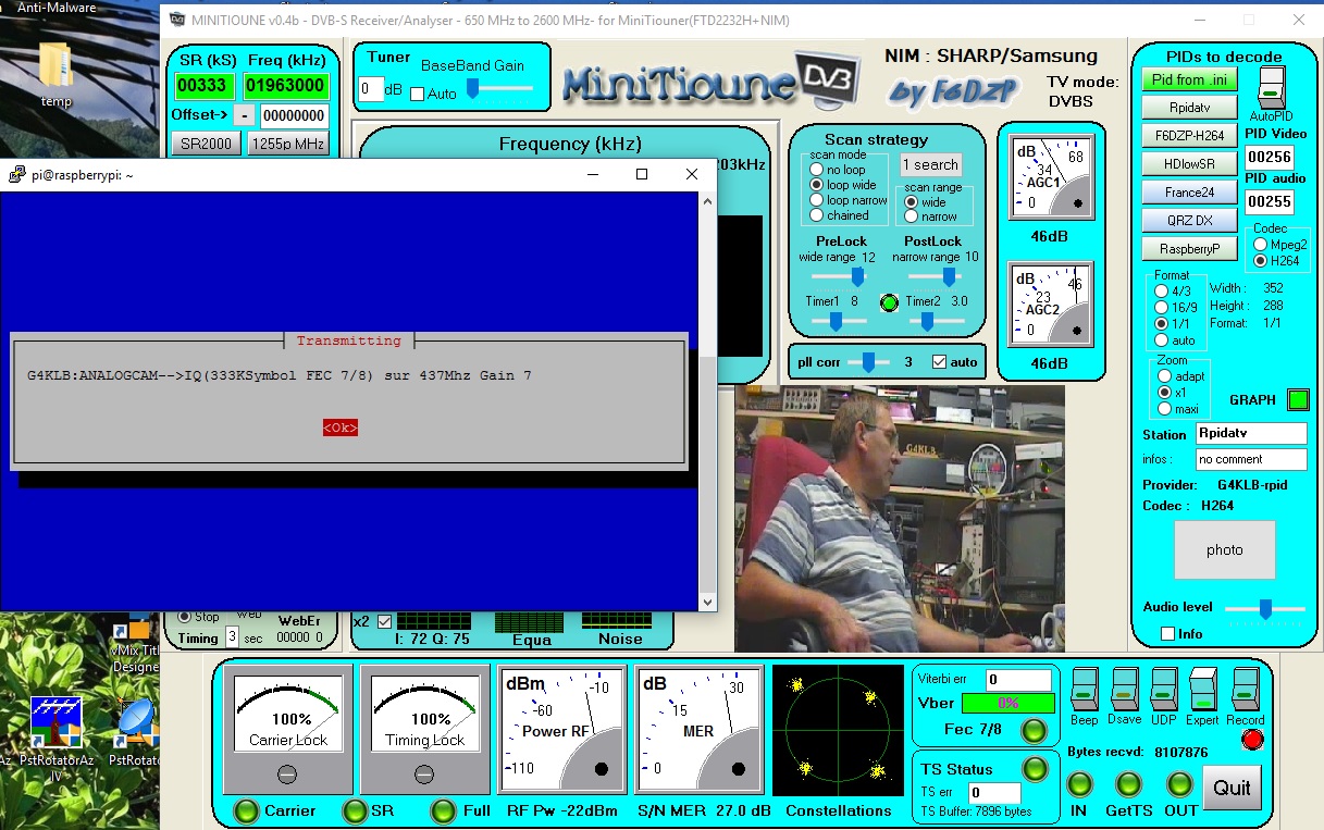

EZ wk.jpg (324.06 KiB) Viewed 10052 times

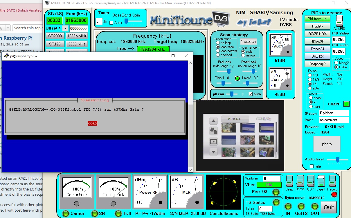

silver wk.jpg (356.93 KiB) Viewed 10050 times
