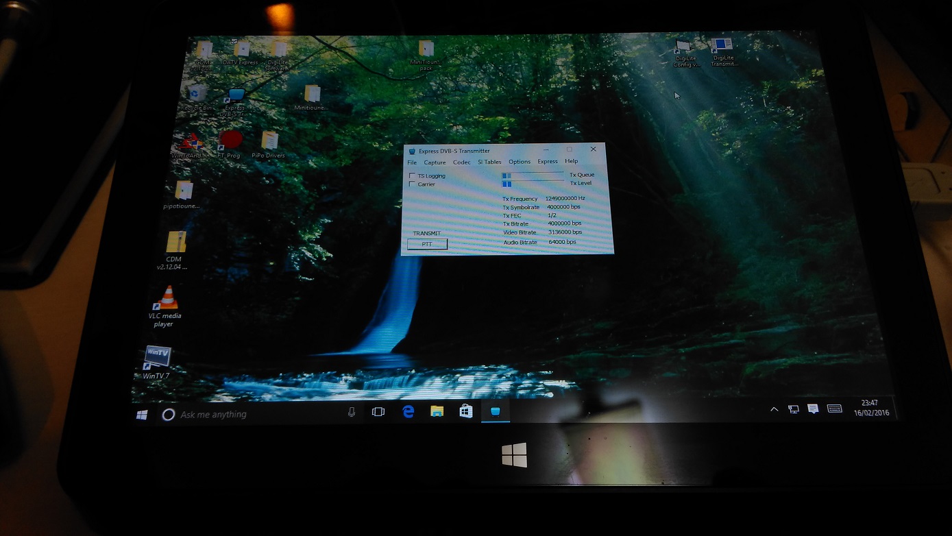

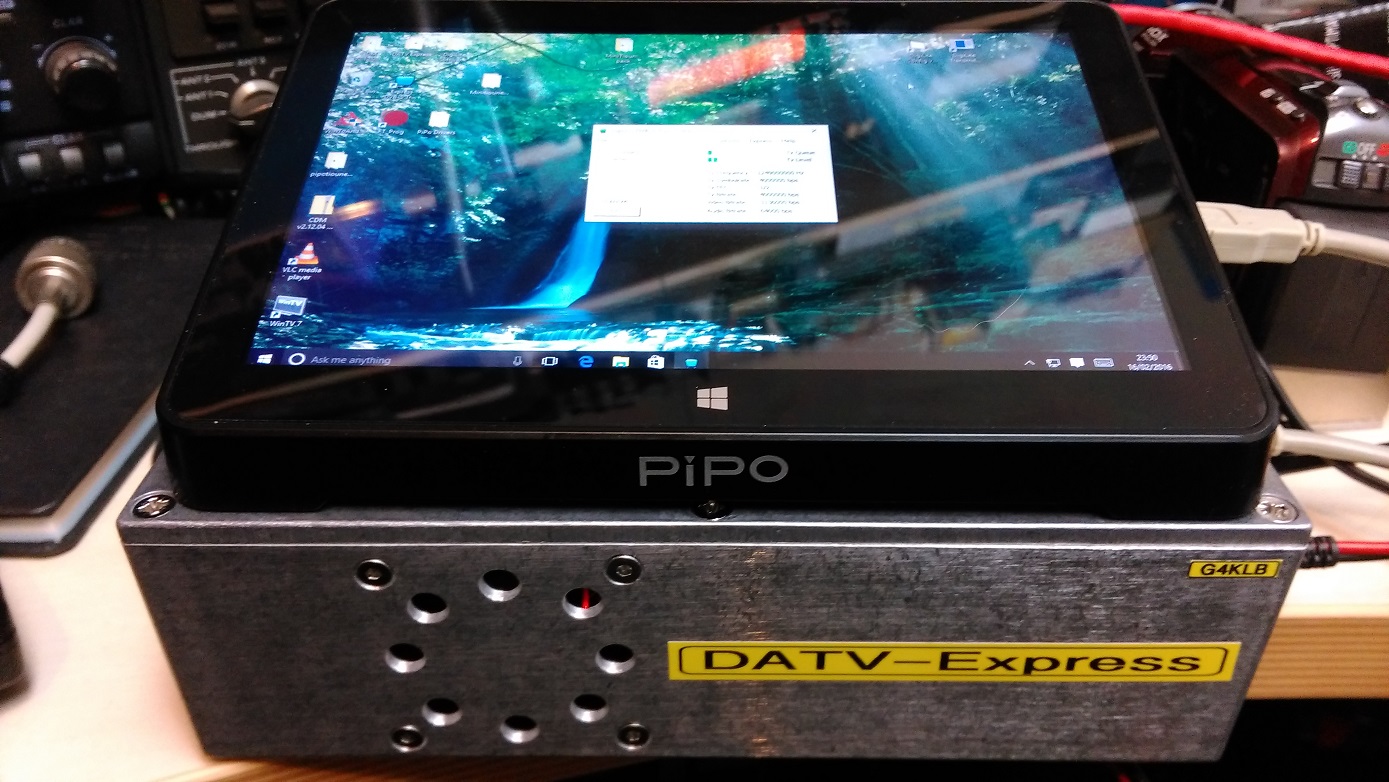

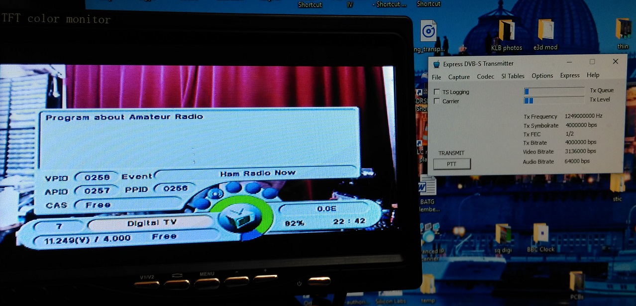

Now that DATV Express has gone to the Dark Side (Windows) I decided to give it another try.
Have it working fine on Windows 10 using only my Logitech C920 webcam for both sound and vision :D
I hadn't been able to get that one to work on the previous version.
No messing with graphs and codecs it just worked :o

G4KLB
Posts: 252
Re: DATV-Express Project - January update report
Post by G4KLB » Tue Feb 16, 2016 11:54 pm
Thanks Charles,
Best way to do it .......for us :D
Now had the same painless (for me) experience on the PiPo.

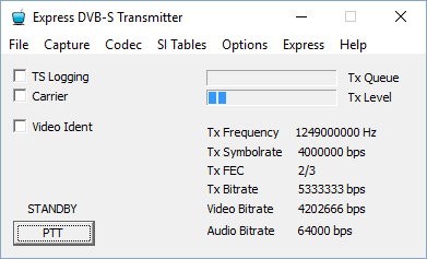

Works also here in HB with vMIX. I have difficulties (little) to have a smooth image. It is not the pc, a i7-2600k 3.40 GHz. For the time being, I had no success with my Logitec webcam...
A small cosmetic point, the TX Bitrate value is rounded. Would be nice to have it to the last digit. I have seen with TSReader that the mux bitrate is correct for a given SR and FEC.
Thank you Charles for this development !

Hello Michel,
The TX bitrate is not rounded but is simply the Symbol rate x 2 - Convolutional FEC overhead. I have not allowed
for the Reed Solomon overhead. I may change that.
Sorry about the jitter, is it due to signal dropouts? Does the tx queue fill up? or maybe it is just a regular flicker
on movement.

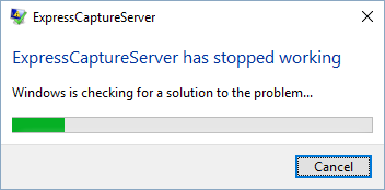

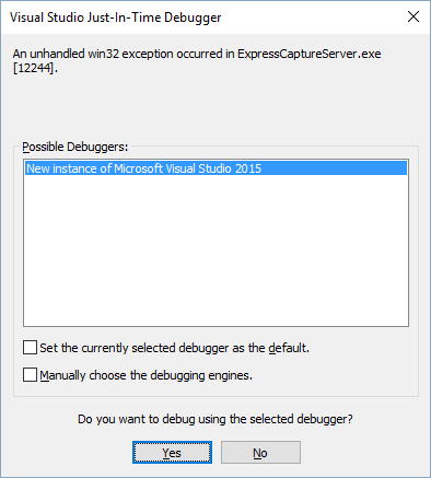

I was able to test the new version today. Unfortunately it is crashing after pressing PTT:
DATV-Express stopped working debug.png (12.73 KiB) Viewed 9348 times
Pressing PTT:
DATV-Express crash.png (7.12 KiB) Viewed 9348 times
Debug Info:
DATV Express.png (11.04 KiB) Viewed 9348 times
Configuration is Win-10 64bit i7-2400k/16Gig
Previous version was working ok.
73 Koert PA1KW
***UPDATE***
First time starting the program you have to enter the Video Capture Settings and especially the Device Format. In my case the device format was empty. After entering the device format it is working ok!!

Posts: 736
Post by G4GUO » Sat Feb 20, 2016 4:06 pm
Fine, that is useful to know. I did put some traps in the code to stop it
crashing with empty fields but I missed the format one.
