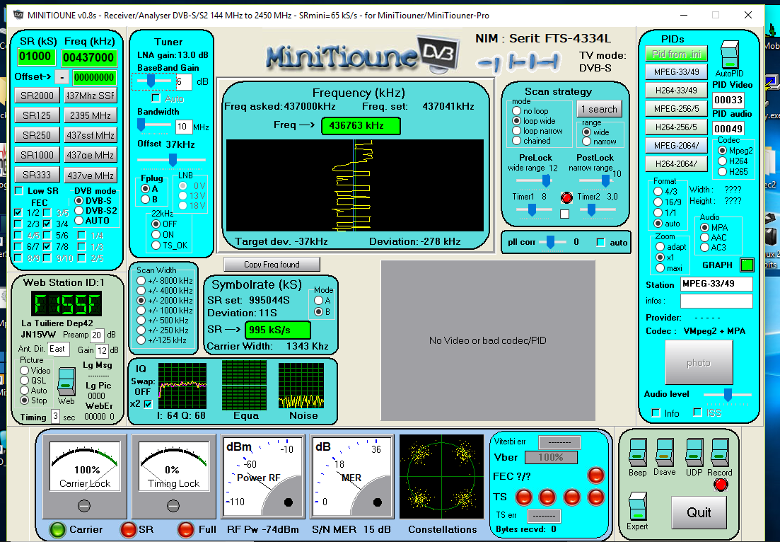

You can see the interrupts on Titioun monitor. Same problem on 1249Mhhz >>> no Synchro (PID are 33/49 in datvexpress)

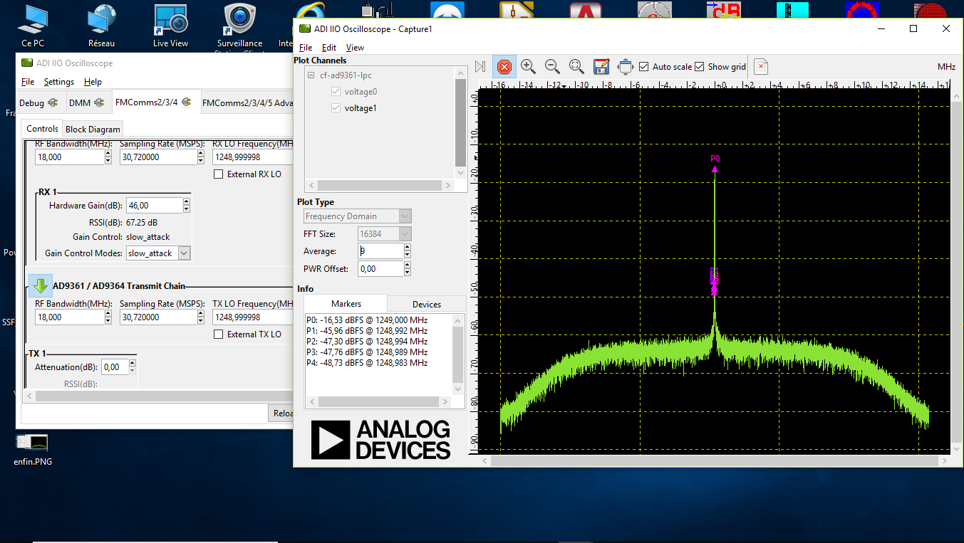

Yes I have glitchs, I have not powered usb hub, but i have powered the pluto, it is same problem.

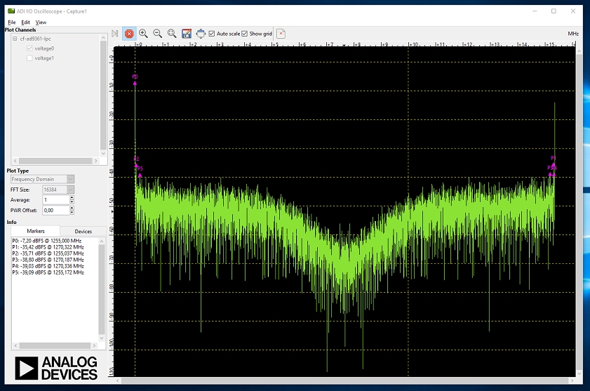

My signal is not good. I have try to test it with IIO Oscilloscope ( software from Analog device and cable short) , and I think there are a problem.
adi setup.PNG (67.13 KiB) Viewed 11768 times
look, marker at 1255 (P0) is -7db at the left side....... :(
adi scope.PNG (146.33 KiB) Viewed 11768 times

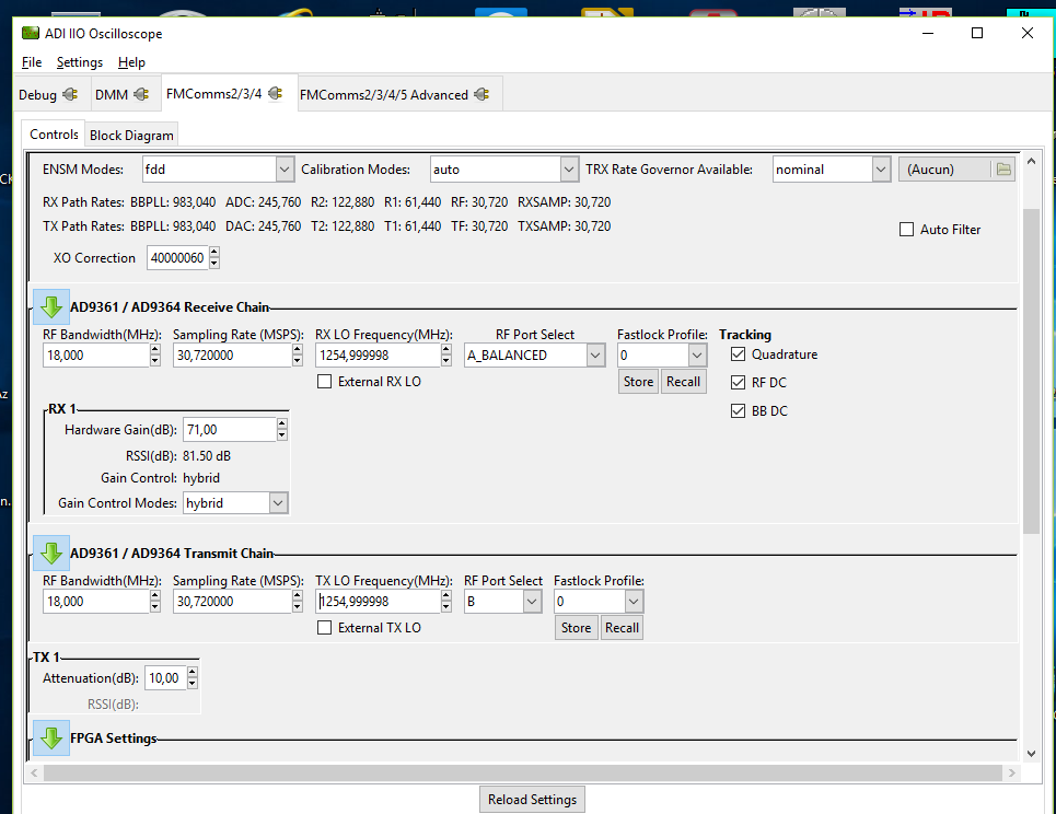

But after adjust the parameters in IIO Scope, my signal is best, but I think I have problem with my TX Pluto output, because PO marker is not stable , and the signal level PO is low.
If some one can released this mesure to compare....
Software is:
.https://wiki.analog.com/resources/tool ... cilloscope
Thk's 73 Franck

Happy new year. Just for information my Pluto run very well now, it was an offset ajustment with my Minitioun. :oops: :oops:
I have test differents frequency, mods, SR > 500, it's ok 100%.
Thank you for your support.
