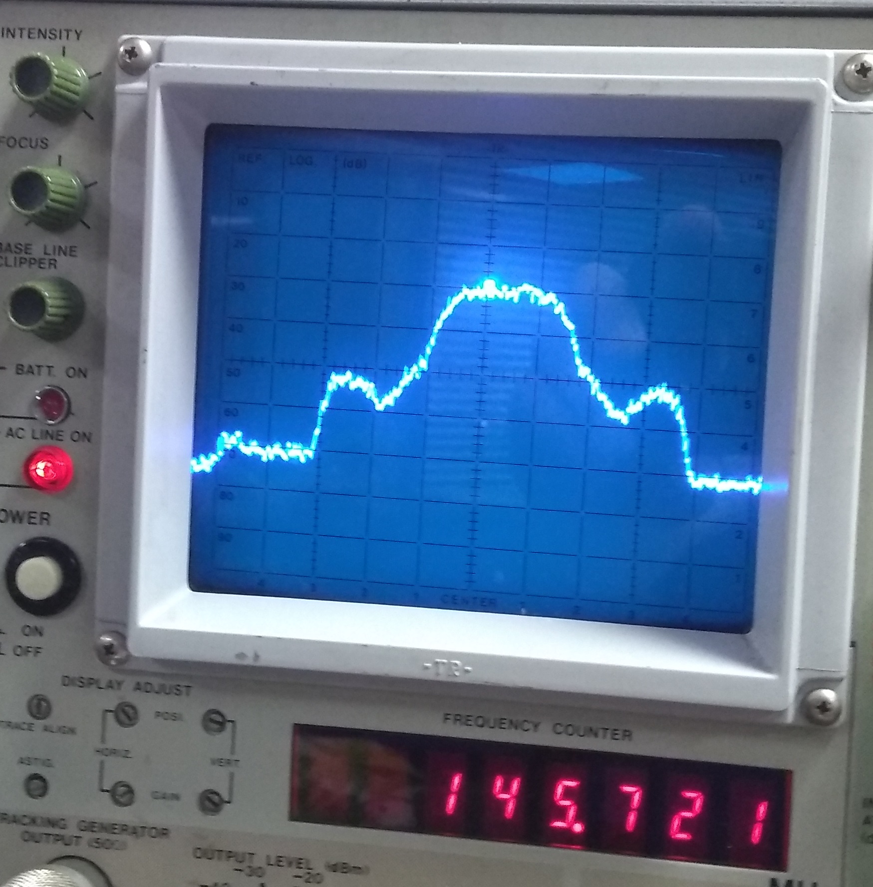

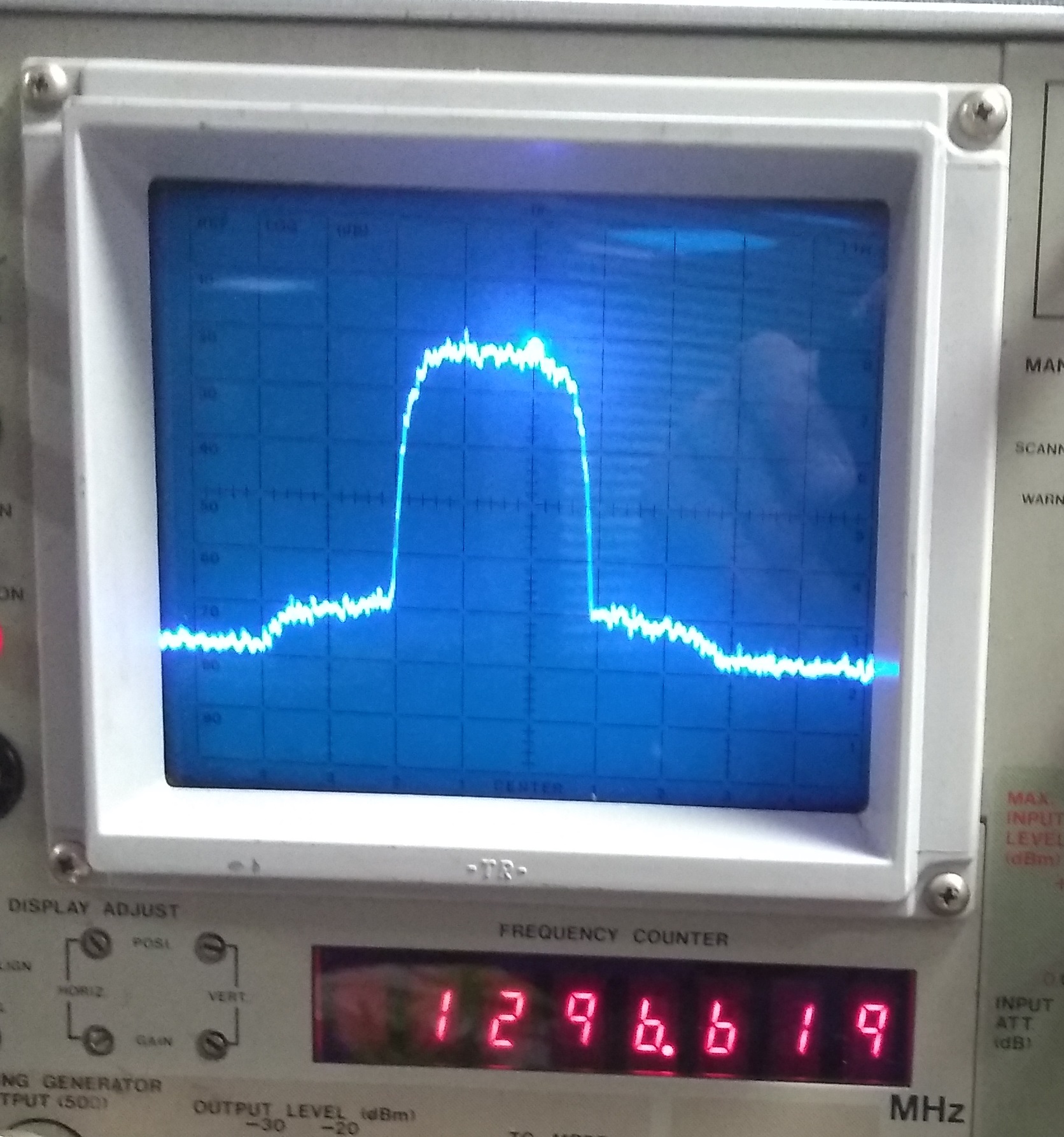

Power to the Pluto
I was able to test it on a calibrated SA from 50MHz up to 1300 MHz. At the lower frequencies it was drivable to distortion (shoulders above -35dB) but at 1296 it was OK on full Pluto power. As a rough indication we were getting about 22dBm (150mW +/-) so a useful increase in terms of driving other things. Linearity can be maintained on the lower frequencies by limiting the Pluto drive level in Express DVB. As the amp runs from 5 volts that should be available inside the Pluto case, yet to be investigated. A neat solution.
Link again: https://www.ebay.co.uk/itm/LNA-0-05-4G- ... Swor1aT0Vy or this one in a posh metal box https://www.ebay.co.uk/itm/Low-Noise-LN ... 0005.m1851
Onwards to finish my Portsdown properly now

That's good info about the amp Gareth, thanks. What is the active device in there, I would like to look at the datasheet.

So small I had to dig out extra magnification - I assumed it had been scrubbed off! Its a SPF5189Z. https://www.qorvo.com/products/p/SPF5189Z Not bad for a £5 with SMA's and board!!
Spectrum as shown.... Looks like its good to 13cm too, unlike my colleagues SA!
Driven by 2000KBs/pluto/webcam
