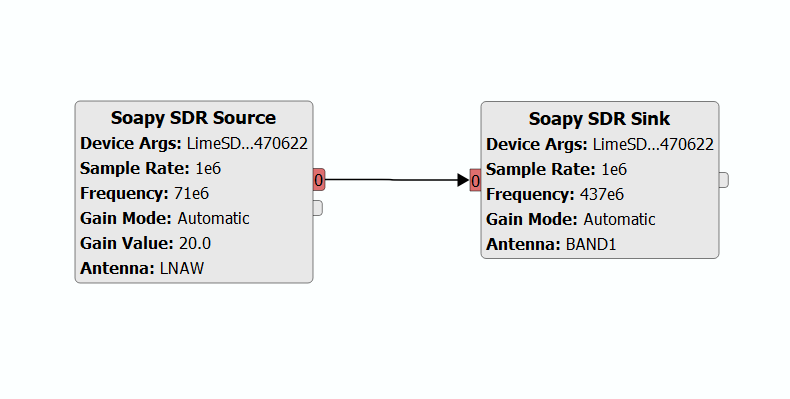

MJW Why do you need a 4m up converter? If you have a Pluto you can program it to convert 4m to 23cm to feed into a minitiouner.
A how-to for CQ-TV maybe Mike?

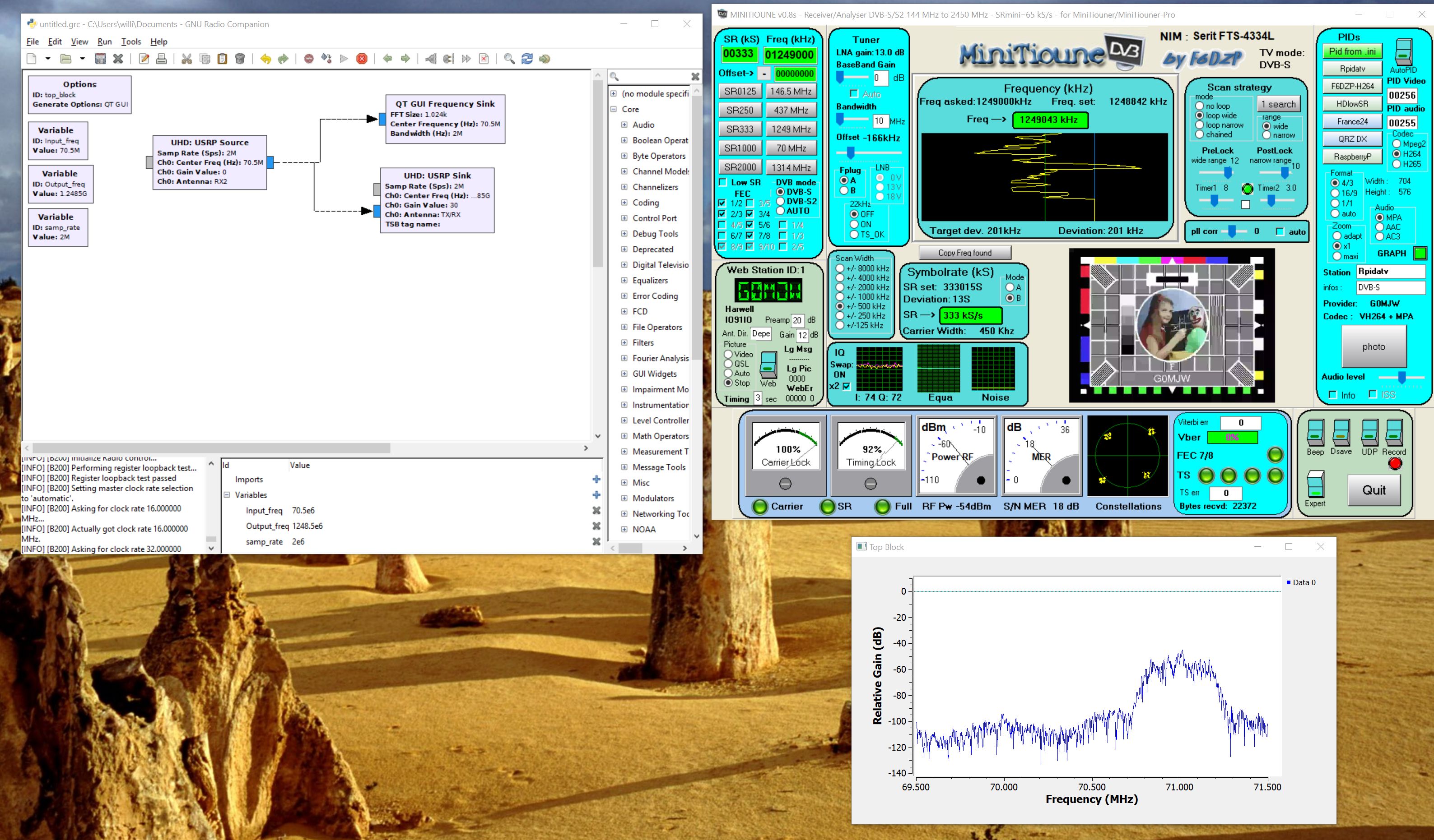

It is fairly simple to set up a transponder in a package like Gnuradio (Linux, Windows only if you have to) or PothosSDR (easy to use Windows package) which will be fine for 4m over USB2. All you need to do is use it to set up a source and sink, connect them together, set the sample rate, frequencies and gain, maybe some filtering and run it. Crude but effective. This is with my Lime as my pluto is running its web server at the moment.
For wider bandwidth better to do it on the device itself. I am not sure how to do that yet, but others have been doing interesting things. See plutoweb https://www.rtl-sdr.com/ for inspiration.
Maybe a better example.
