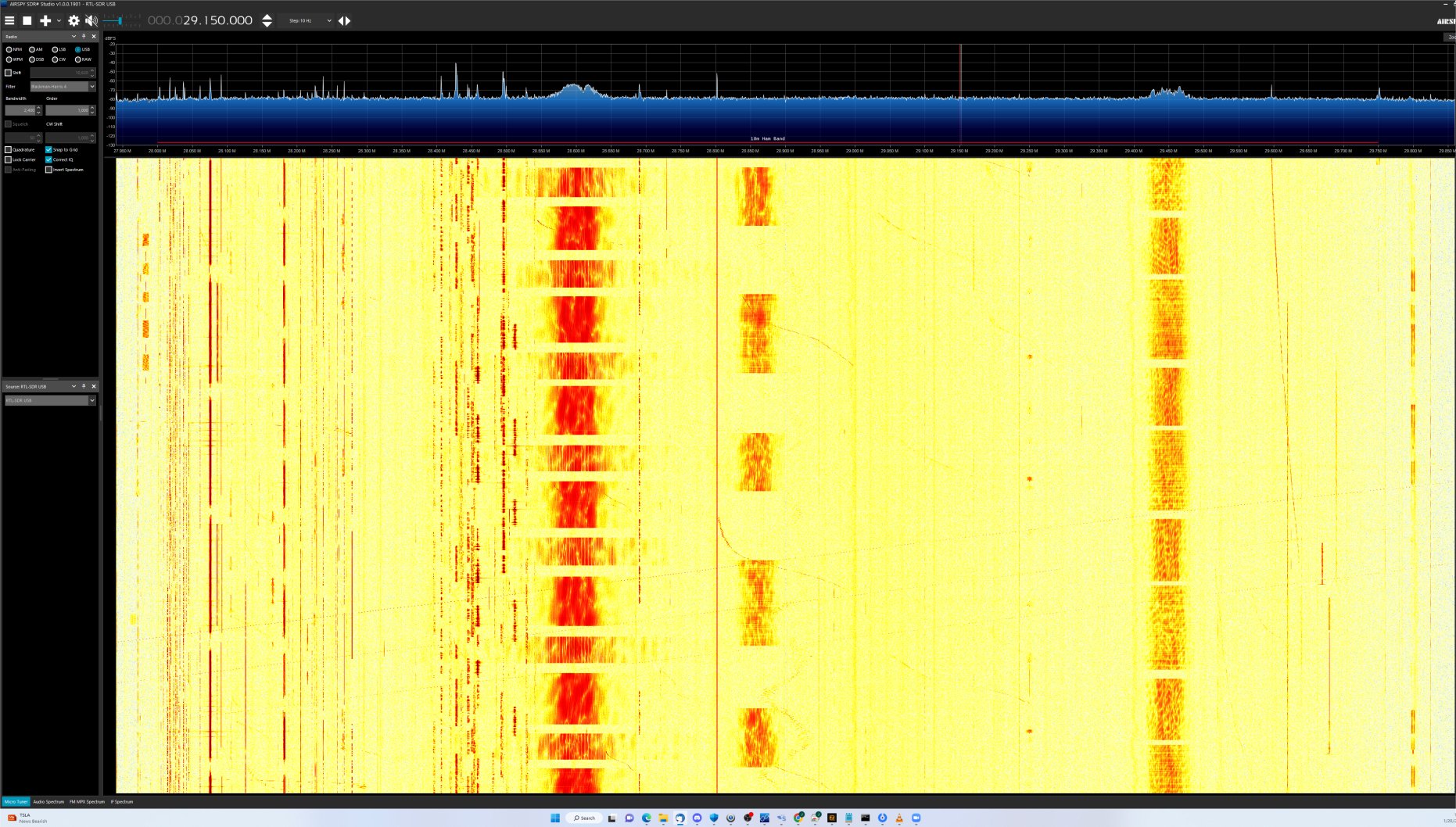

Anyone recognise these wideband signals? They have been showing up in the early mornings for the last week and fade away by noon. They look to be 60-80Khz wide. Wonder if they are some kind of Radar?
John : K0ZAK

Post by G8JNJ » Sun Feb 05, 2023 12:29 pm
HF radars
Plenty of them about, all using different modulation types, repetition rates and bandwidths.
Radars located in Cyprus, China, Russia and Iran, are usually the ones most commonly heard.
