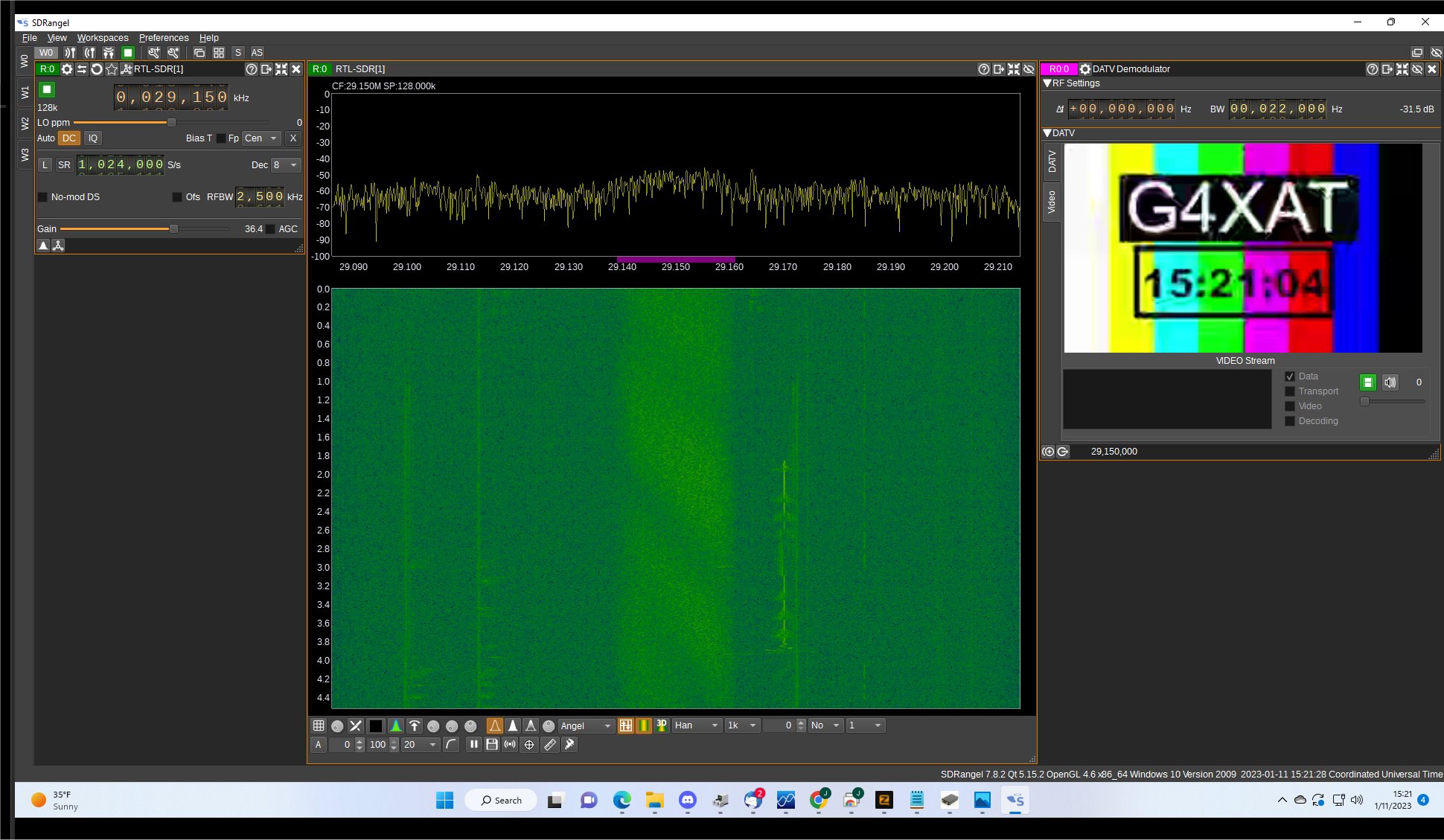

Steve G4NZV suggested this fix and it works!
In the SDRangel Device select box press the 'X' then the IQ button to swap the IQ to QI [if you have an inverted spectrum]

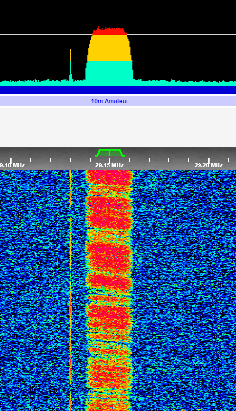

Turned more DC into heat this afternoon having changed the fan on my PA for something with a LOT more airflow. Propagations different again with fading but not as frequency selective as before. up to 22dB above the noise on the Milford PA Kiwi SDR and John also decoded a few single frames.
Recorded a few strong bits so will try local decoding of them next.
I was able to decode a sequence of individual frames from Gareth this morning, but not enough to be called motion. Signals were up and down quite a bit. Was watching with two different RTL-SDR dongles, a HackRF one, and a Adalm Pluto with a Ham it up upconverter. The two RTL-SDR dongles & the HackRF One were decoding data, but the Pluto wasn't. Best decoding was done with the 'RTL-SDR Blog V3 R860 RTL2832U RTLSDR 1PPM TCXO SMA'
