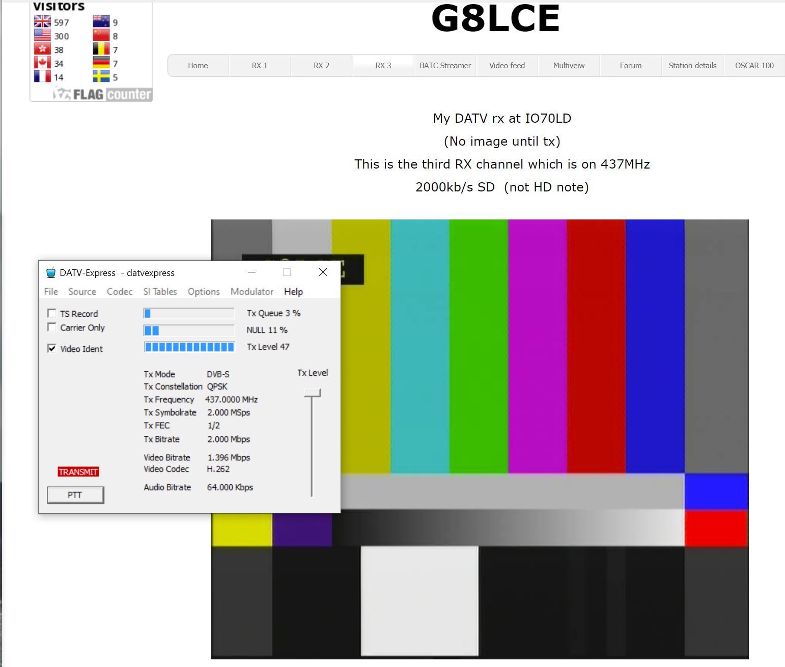

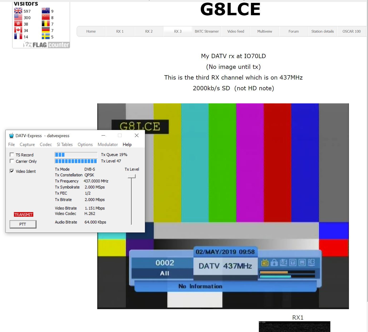

I have found a problem using Datv Express with a Pluto TX. With _v1.25LP14 and a satellite rx using a sup 2400 ( So 437MHz 2000Ks DVB-S H.262 ) When I stop and start TX using PTT the Pluto does not TX again a signal the rx understands!! When I revert to v1.25LP9 it works as expected. Restarting the new version each time you want to tx makes it work again. My computer has two display cards as it is used for video editing and GoPro Fusion rendering. Could that be causing it to crash on PTT switching? Two rx show the same problem.
g8lce
Posts: 435
Re: DATV-Express Project
Post by g8lce » Thu May 02, 2019 2:32 pm
The fault with version 14 is only with H.262 codec ( it is an old satellite RX!) The PTT works fine with H.264 and a more modern satellite rx.
