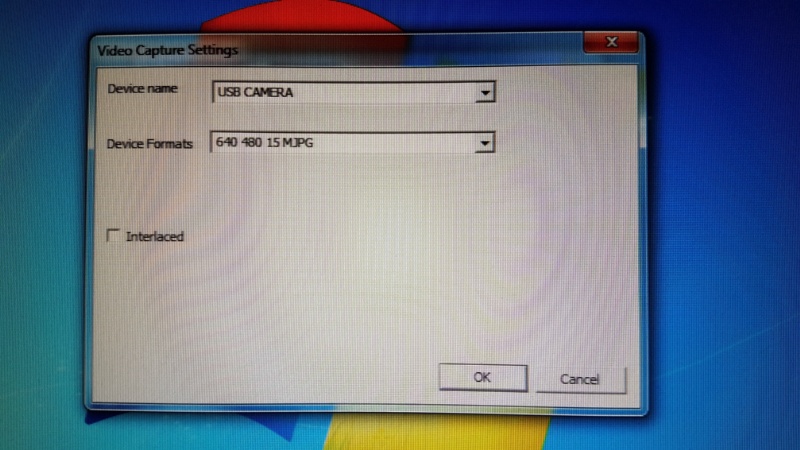

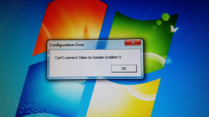

Trying to get mine working with Express DVB but struggling to get a video source working. My camera is listed but I get the error message "Can't connect video to Sample Grabber 0". Really hit a brick wall.
73 Dave.

Hi folks,
I've worked it out! It's my camera that doesn't support an analogue mode. I've installed the software on my laptop and it seems to be working fine on that! I've connected up the Minitiouner and confirmed my findings. Sorry for the bandwidth. Must try harder...
73 Dave
