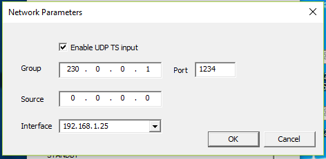

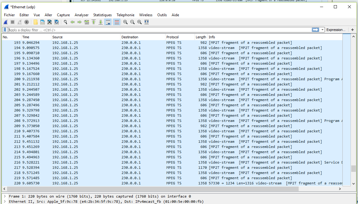

Charles, I have a problem to use UDP.
I have a batch file to genarate TS Stream on UDP/210.0.0.10:10000
When I control the flux on my lan with Wireshark, I can see TS flux from source to the correct destination .
But DATVExpress don't listen, I don't understand why, windows firewall is OK for Datvexpress and ffmpeg.
Can you help me please?
73 Franck

Franck,
Try seting Group to 210.0.0.10 and source to 0.0.0.0
- Charles
- Charles
Re: DATV-Express Project
Hi Charles,
yes it's good, I'm too purist
for me source is source ..and me ffmpeg stream it is my source
Many thank's
73 Franck F1SSF
Many thank's
73 Franck F1SSF

,I use normally my LIME in UDP input mode, I wanted to test my pluto again, I return with my LIME and I still find my problem, DATVExpress is deaf in UDP. I did not change anything, fire all, stream, listening are OK....
What do you think about this? What do you use like IP segment ? Thank you very much
EDIT POST 21/04/19 > I find my problem.
I had meanwhile plugged my pluto that uses the IP address: 210.X.X.X, but this address is outside the standardized IP values. So I handed 230.X.X.X, and it works, sorry for the confusion.
I corrected the screenshots above whith correct IP, because they could be misleading.
73 Franck F1SSF
