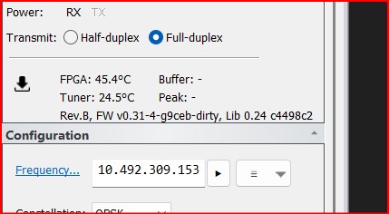

Re: Pluto Which firmware?
Hi Russ
I followed all that and still the Portsdown says it is the wrong firmware version.
In desperation I also bought a second pluto with the same result.
Simon Brown has a new s/ware build out called SDR Television and that shows what firmware version is installed on the pluto (see pic)
It confirms I have the right version installed yet the Portsdown disagrees !!
I have ordered a couple of SD cards and will re build the Portsdown 4.
tthat is the only variable .
If that fails to resolve it......
Watch this space
Nick
Watch this space
Nick
Hi Nick
Please re-check the IP address set in your Pluto and check that the same address is also set in the Portsdown Config.
Also check that you have nothing else that might be stealing the IP address.
My guess is that the Portsdown is connecting to something other than your Pluto.
Russ
As I had the 2nd pluto
I tried it on my Lime Portsdown and Eureka it reports the correct Pluto build.
It has to be something to do with the build !!!
Very strange
Hope when I get the new card it too will work properly
Nick
Very strange
Nick
Russ
I performed surgery on the PD4 that was complaining about the Pluto being the wrong version.
Why when a project is finished is it so hard to get back in to !!
I removed the Pi SD card and re flashed it.
Now it sees the Pluto as having the correct firmware etc.
Nick
Nick
