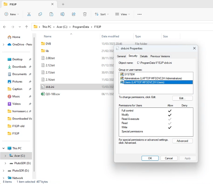

Operating YTV's laptop remotely I configured the Easy to go through GB3EY and on its Ryde Rx the transmission came up as 333kS/s whereas i had set the symbol rate to be 1000kS/s. The parameters for Easy are held in the file dvb.ini within the hidden folder C:\Programdata\F1EJP
The file's last modified date was in early January when the software was installed. Clearly, the .ini file was not being updated by the application! The cause was found to be a permissions issue. The username Users was only assigned read and execute permissions.
Changing the permissions for that user to Full Control allowed the app to update the .ini file and now it will run for more than 15mins without a dropout using 1000kS/s, FEC 2/3 & H264 with the nVidia encoder.
To change the permissions, right click the .ini file, select properties in the dropdown menu, select the security tab, highlight users and then click edit. check the full control box and then click OK. You should then be able to see that the file's last modified date & time match when you changed the app settings. The bold checks in the screenshot show the added permissions.
It didn't affect my system because I run Active Directory from a Windows Server; my Windows login confers administrative rights across every file on any PC.
Clive
Edit: It's a lot better than it was but it's not the whole solution. it seems to get worse the longer you leave it on. Rats!!
