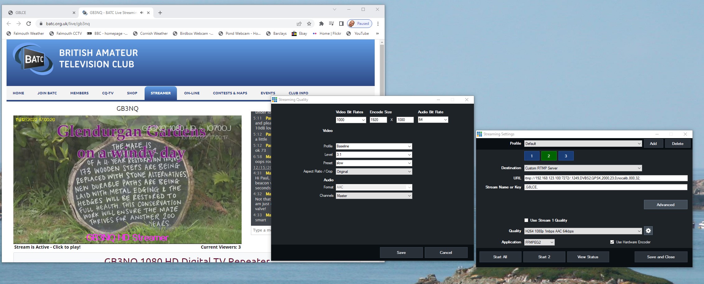

Further testing showed that there were still some lockups. I then changed things again and found some settings of vMix that worked through the repeater (GB3NQ) without locking up the stream Ryde.
vMix settings.jpg (337.25 KiB) Viewed 3877 times
The Profile and Preset are the ones that made the most difference. The slower the less lockups!

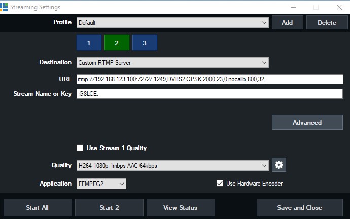

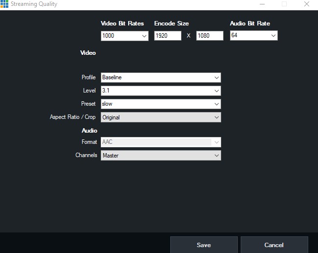

Bigger images:
vMix settings 1.jpg (31.89 KiB) Viewed 3876 times
Martin G8LCE
vMix settings 2.jpg (47.51 KiB) Viewed 3876 times
