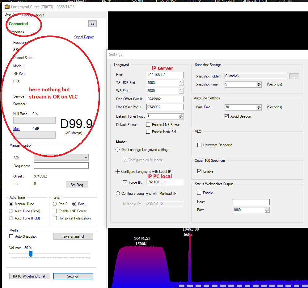

Hi alls
I have installed longmynd server on RPI + Minitioun, it run and stream .
I can read TS flux with vlc.
But impossible to read fllux with the longmynd client. I don't understand why?
Thank you for support.
73 F1SSF franck

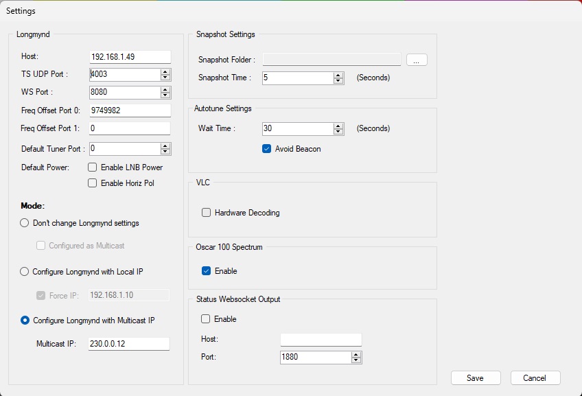

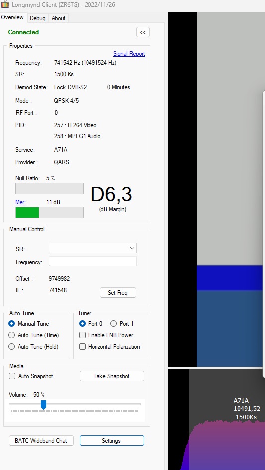

Re: Longmynd Client HELP
Hi Frank,
I had to go back and look for my setup.
This works for me.
Raspberry is at x.x.x.49
and i configured a mukticast 230.0.0.12
Hope it helps..
Benno

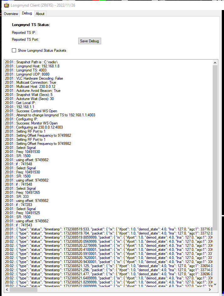

Hi Benno
Thank you for your message.
Same setup that you, impossible to displaying in longmynd client screen, only on VLC.
I don't think it's a firewall problem, because port 4003 is open (VLC read TS on 4003) , and longmynd too since it shows me the BATC spectrum
See debug windows ans statut packets
- debug.png (105.97 KiB) Viewed 8489 times

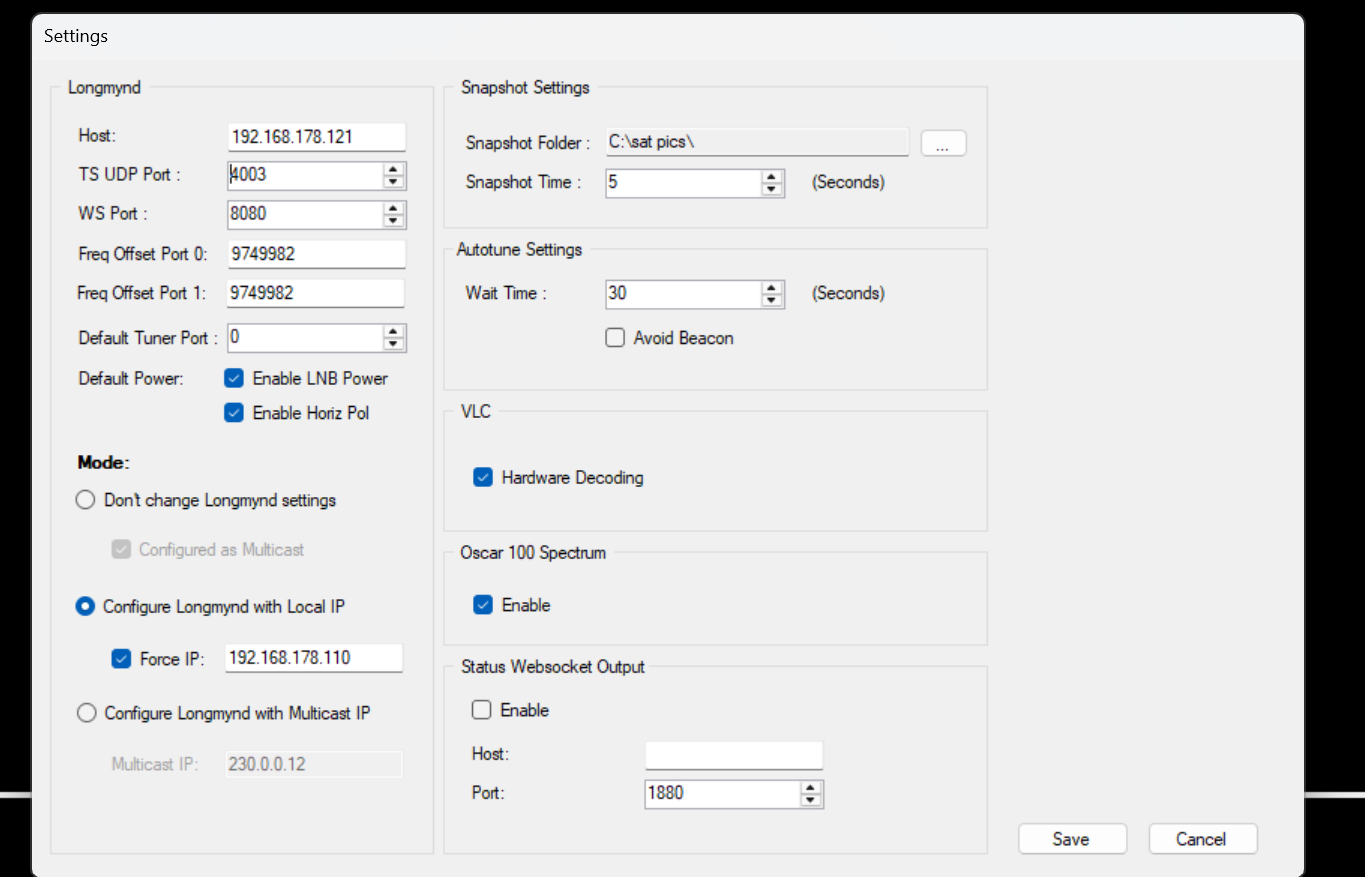

Hi Tom
I too have upgraded to a Win 11 machine and am struggling with longmynd.
This is my dEBUG .
0:36 : Snapshot Path is : C:\sat pics\
20:36 : Longmynd Host: 192.168.178.121
20:36 : Longmynd TS: 4003

I switched OFF the win 11 firewall .
My setting screen is as you detailed..
Yet it will not connect?
WB chat all works so maybe the Longmynd sd card needs a rebuild??
Any advice would be greatly appreciated
Nick
Tom I solved it but !!
My Pi is 192.... 110
The Host PC running the client is 192.......121
In the settings config I have to put 110 (the pi) as the Host and 121 in the Configure Longmynd IP??
Dont understand but it works..
Next to adjust my dish
Nick
