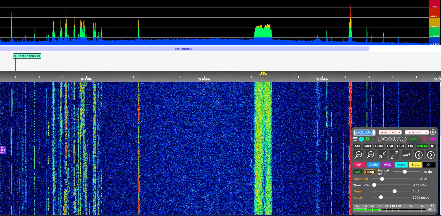

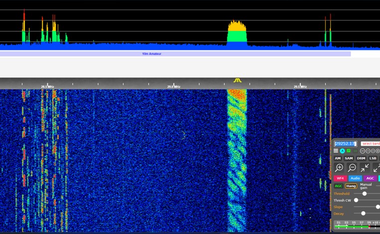

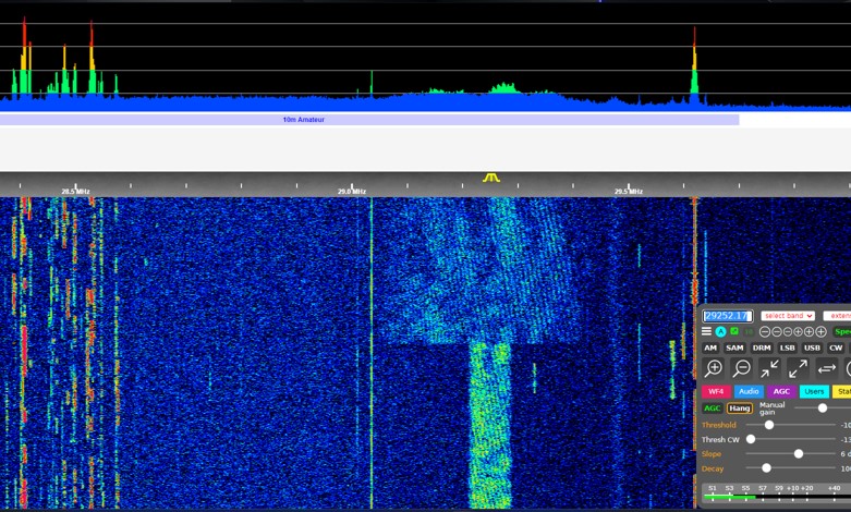

I've got my TX rigged up now.

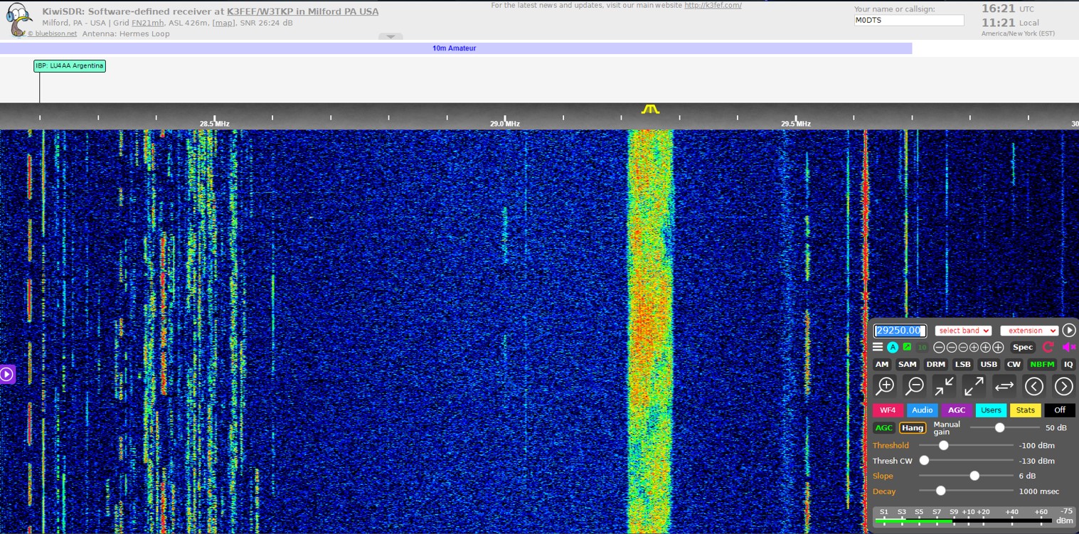

I can see myself on a kiwisdr nr Washington: http://kiwisdr.k3fef.com:8073/
If someone had a good antenna and rx maybe it would work, but would have to catch it when the fading is not as brutal!!
DRM mode may be the only way.
This is 66Ks DVB-S2, 29.250MHz.

- sdr rx_fading.jpg (815.43 KiB) Viewed 6555 times
- sdr rx.jpg (566.43 KiB) Viewed 6555 times

Found your callsign and just heard what sounded like distorted sideband on your frequency. Possibly another operator.
Steve
Steve
Yeah, there's a few signals come up since i posted!
Signal is very QSB, that's 100W into 3el yagi here.
The Rx says it's a loop: https://sites.google.com/view/vk1hw/ant ... ermes-loop

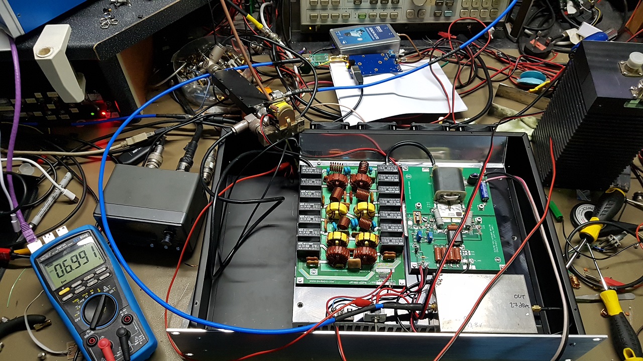

Been playing with this little amp https://sites.google.com/site/rfpowerto ... ower-tools which I built a couple of years ago.
From Mikes transverter O/P into a 20db eBay amp gave 0.1W. Then into this amp gave me 6 watts. More was seen but tweaking the bias greatly improved the 'byproducts' until I think I have popped the device (really need a current limited 50V PSU.....). No smoke but its stopped amplifying......
I have several spare PCBs for this amp if anyone would like one....it would probably be good for a beacon amp running relatively QRP if the band obliges 5W will probably work.....or I suppose tunr down a MRF300 would achieve the same.....tx output filter also required....

The DATV source:
Pluto -> ham-it-up converter -> SPF5189 -> RD06 -> BLF188 and LPF.
Image below, excuse the tip of bench, work in progress!!!!!!
You maybe able to hear some backscatter from me on ssb maybe but DVB unlikely as it will be too weak.
The DATV source:

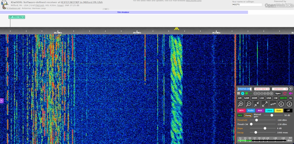

Stronger than it was now, but major frequency selective fading.

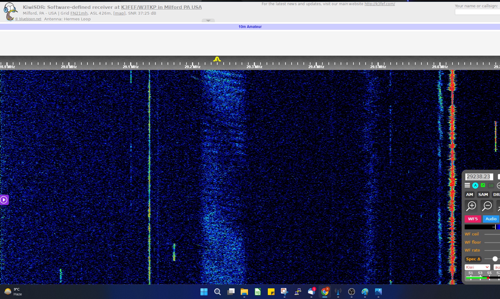

good signal on my local kiwisdr only about 2 miles away.
http://planet3.dyndns.org:8073/

Possibilities with this sort of strength, more stable too.... interesting.

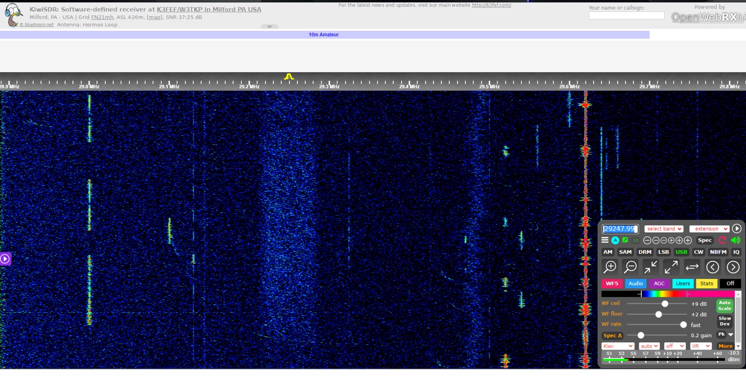

Some more images of Today's tests, Tx is now off as conditions have faded in darkness.
The strongest peak came up to 20dB/noise on the websdr.
I did a comparison with 66Ks DVB-S2 vs 333Ks DVB-T.
