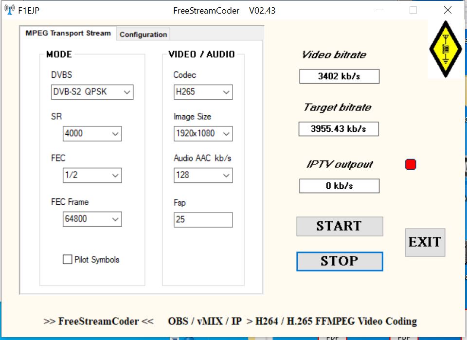

Hello
very soon now!
to wait here is the documentation
73 to all
Dominique F1EJP
FreeStreamCoder-en.pdf
(938.7 KiB) Downloaded 625 times

Hi Dominique, will the new software allow for streams up to 4.167 M/symbols and FEC 1/2, which is the configuration of my local repeater?
Roger

Hello Roger
SR from 25 Ks to 4 Ms is ok for you ?
Dominique F1EJP

Thanks for the reply Dominique.
As G0MJW has said, a number of older repeaters, including my local repeater (GB3UD) uses 4.167 M/s. If you have the opportunity to add that, it would be great. As someone relatively new to DATV, FFMPEG drives me crazy, so I am really looking forward to trying your program.
Roger

hello G8KWR
Thank you for the explanations.
I will add SR 4167 in next version.
For me the speeds tested higher than 1.5M do not work correctly with the INTEL encoder and crashes on my laptop but the results are very good on my pc with NVIDIA
73 Dominique F1EJP

FreeStreamCoder V02.44 - An excellent piece of software Dominique, and you have obviously put a lot of effort and functionality into it, and thank you for adding 4.167 M/S.
Would there be any chance of adding MPEG2, in addition to the H.264/H.265 protocols to complete the flexibility you have built in, as there still a number of repeaters that are using it?
Thank you very much.
