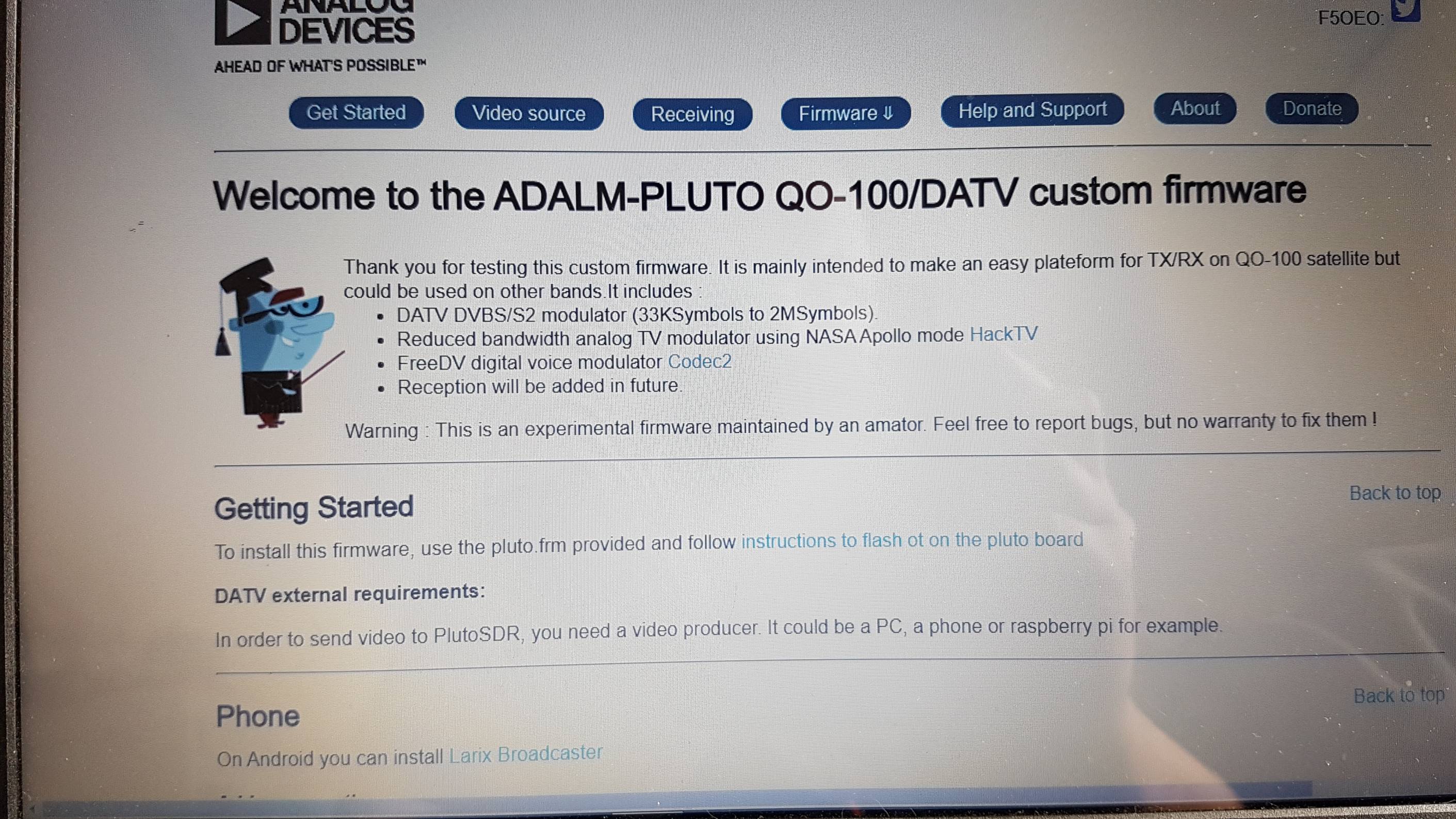

I've spent hours looking for it and nothing. Is my firmware correct?
20200721_173510 (1).jpg (724.8 KiB) Viewed 5639 times
I'm sorry to sound so stupid, What am i missing apart from a brain?

Post by M0SKM » Tue Jul 21, 2020 4:57 pm
Hi Glen,
You need Evariste's firmware http://www.vivadatv.org/viewtopic.php?f=60&t=692#p2796
It's called Beta for the Brave.
There's a control panel to start transmission, my relay works fine with it.
73 Steve

Hi Steve,
I thought this was his software. i gather there is 2 versions?
Thanks for the link i shall change the firmware, (Again)
Glen...

Steve,
I've just reflashed it and its exactly the same. i must have had the right firmware on it. Where is this TX relay button
Glen

Post by g0mjw » Tue Jul 21, 2020 5:16 pm
I didn't realise you had the older version. That explains it I think.

Post by g0mjw » Tue Jul 21, 2020 5:19 pm
glen_turner2002 wrote:
Tue Jul 21, 2020 5:15 pm
Steve,
Glen
That's not the right link. It seems like the firmware pointed to by the correct link below is no longer available.
https://wiki.batc.org.uk/Custom_DATV_Fi ... _the_Pluto
We need to find if it is somewhere else now.

Post by glen_turner2002 » Tue Jul 21, 2020 5:28 pm
Okay, so that will be the problem my firmware that i thought was the latest firmware according to the wiki info isn't the correct one and all the links to the right one no longer work....
Sounds like up a creek without a paddle..
Glen.

Post by g0mjw » Tue Jul 21, 2020 5:34 pm
No - I think what is happening is there is a new version of the Pluto firmware out and it is being updated. The older firmware still works, it just does not support some of the new features, like the relay.
I saw a tweet from Evariste about some new firmware yesterday. https://twitter.com/fonera_cork/status/ ... 0882373632
Why not DM him and ask?
