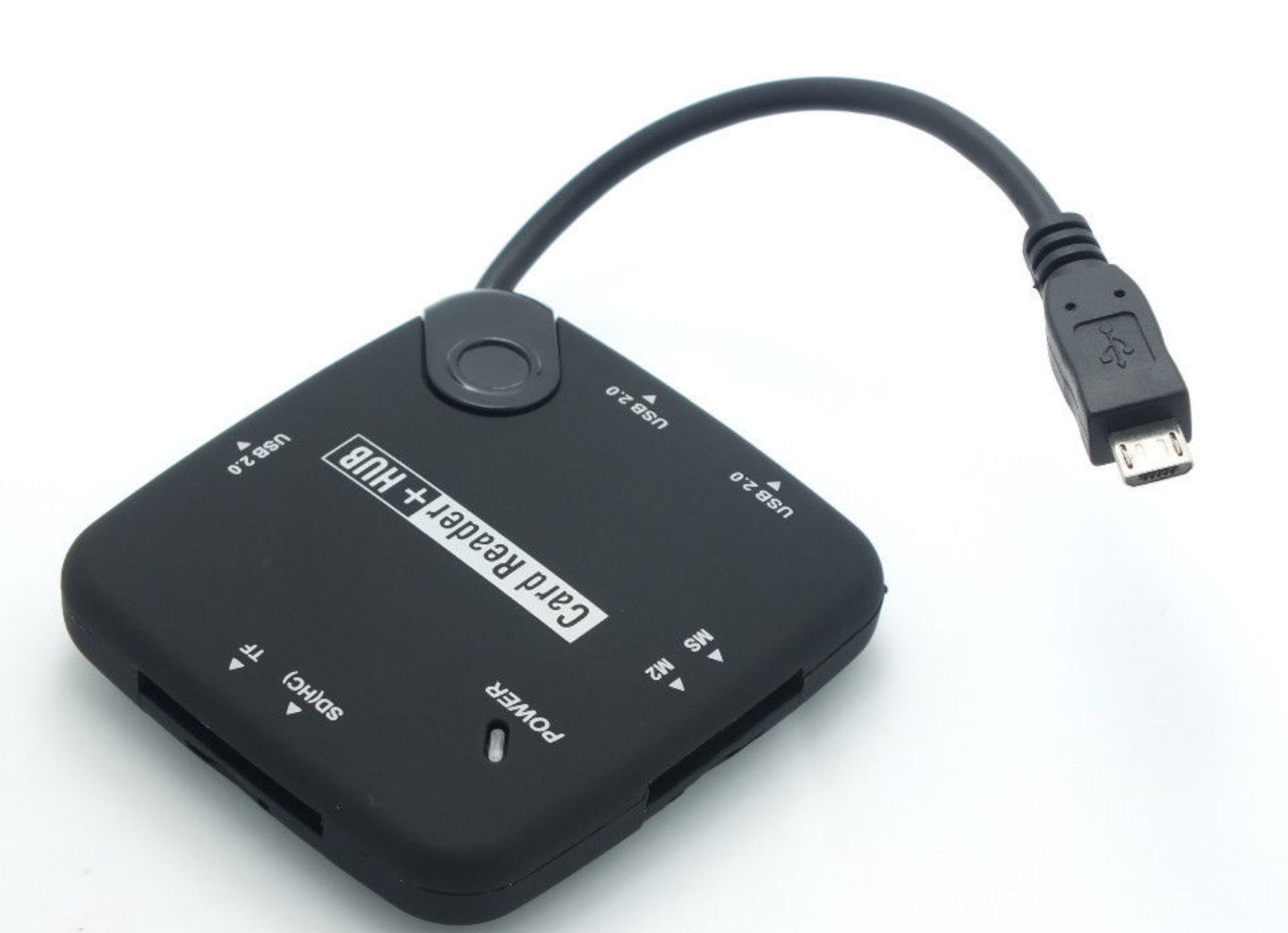

I have this hub with ethernet:
https://www.amazon.com/dp/B00L32UUJK/?t ... brorg08-20
read about this hub here:
http://www.pabr.org/radio/leantrx/leantrx.en.html#
and I can confirm that it works well for my Pluto :-)

That looks ideal. With a micro sized USB memory stick it would keep things neat.

That's not available in the UK but I ordered another one, not ethernet but powered. I will report if it works.
