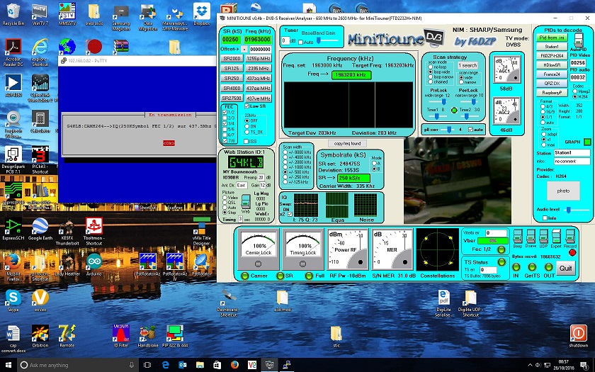

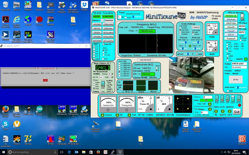

Mine is working with the latest image on vivadatv.
Pi camera on CAMMPEG-2
Notice MiniTioune recognised it as Mpeg2
And CAMH264 Not got as far as trying the EazyCap yet, concentrating on getting the WaveShare touch screen working reliably.
The camera was out of focus, its just one that I changed the lens on, that hangs around my bench.
