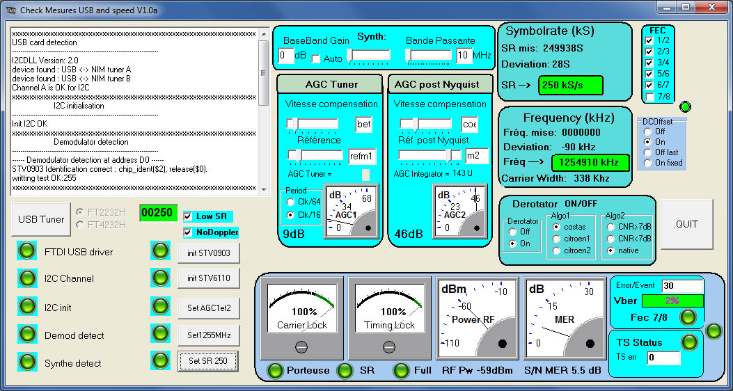

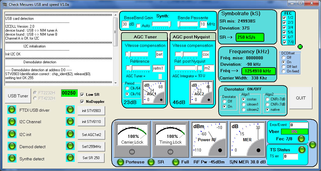

Today I can lock quickly on very low SR with my mini TiouneBox:
-----------------------------------------> SR250
with a bad signal with phase noise:
with a good signal:
So this little TiouneBox (NIM+FT2232H) gives very good resulT.
