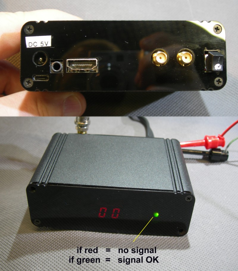

NEW NEW dvb-t Receiver
New product of HiDes, a DVB-T HD receiver for all bandwidths 2 ~ 8 Mhz, MPEG2 and H264, Frequenzrange 170 ~ 950 MHz, with remote control.
Test results on: http://www.oe7forum.at/viewtopic.php?f= ... =120#p1309
- fr-ba.jpg (141.3 KiB) Viewed 6558 times
