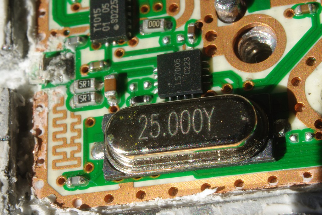

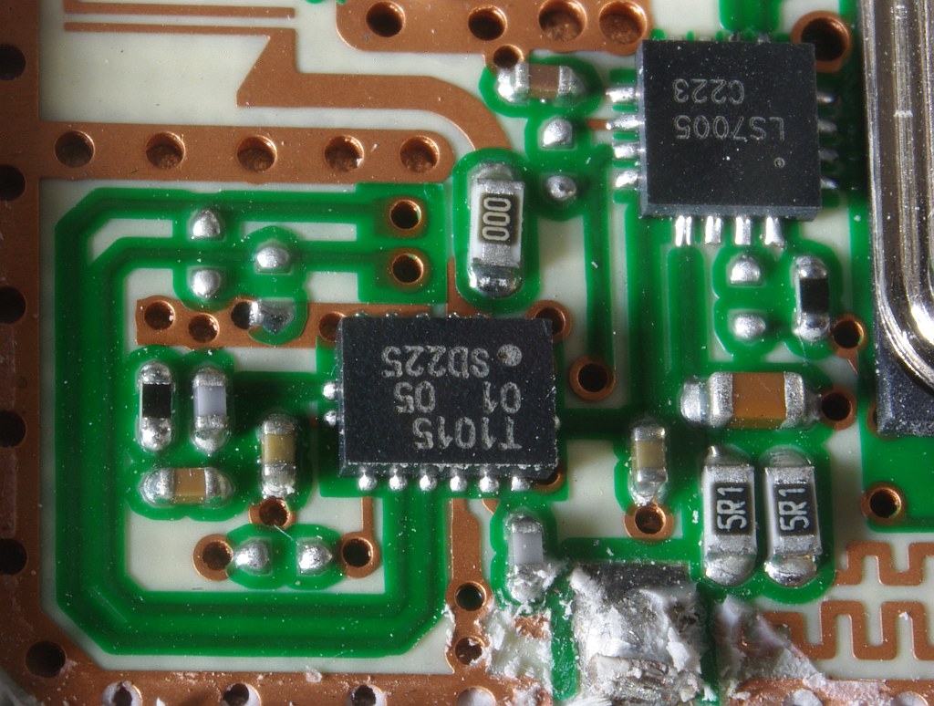

We found another LNB...
This is a LNB from Inverto Digital Labs, typenumber IDLB-SINL42-EXTND-OPP.
It's a single LNB with 25MHz as reference. This could be changed to 23.077MHz for 9GHz LO. Insiders told me that this should work.
Datasheet of the LO/Mixer IC: http://www.nxp.com/documents/applicatio ... N11144.pdf
- tff1015_xtal.jpg (254.37 KiB) Viewed 17657 times
- tff1015_pll.jpg (251.16 KiB) Viewed 17657 times
