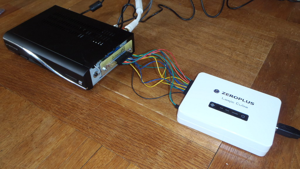

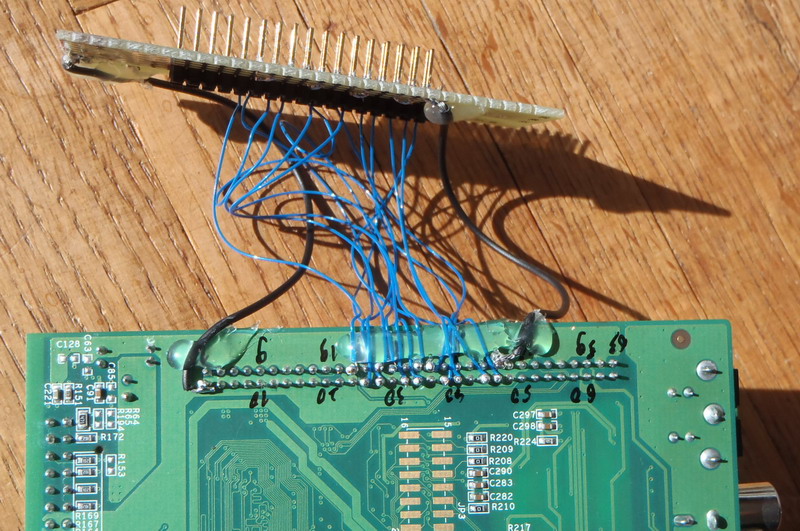

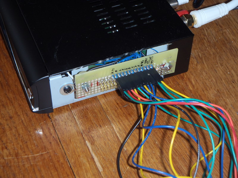

I am currently playing with a "Dreambox".
I soldered an external connector, that can interface the NIM (tuner+demod).
This connector gives access to I2C (SDA/SCL) and Transport Stream (D0-D7, CLK, Sync, Error, Valid).
Currently, I use it as an output, especially to understand how the I2C dialog works, and also transport stream. But I believe that this could also work as a TS input to the Dreambox, if remove the tuner board. I will test that later.
I will keep you informed.
