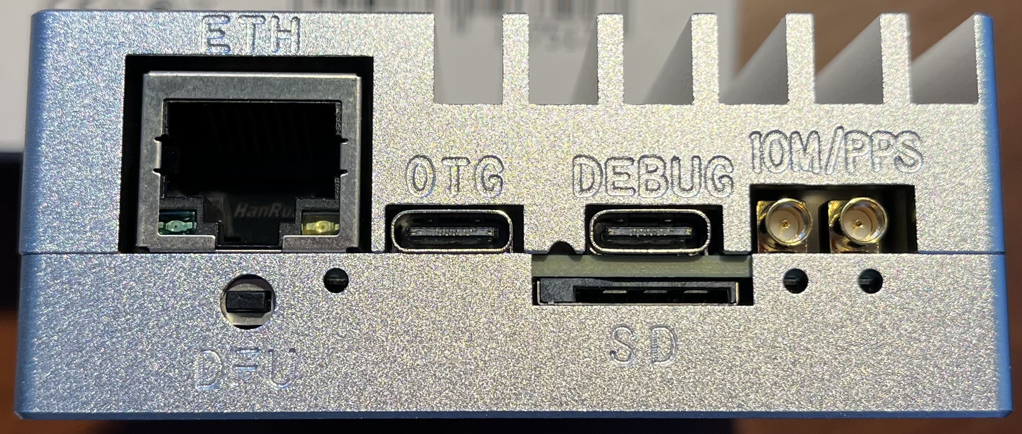

Post by EA7KIR » Wed Mar 11, 2026 4:26 pm
What type & sex connector is needed for the 10MHz Ref input?
Michael EA7KIR
Basil
Posts: 440
Re: LIBRE SDR - The new Pluto??
Post by Basil » Wed Mar 11, 2026 5:15 pm
MMCX (male) for both reference inputs. If you want to use the more popular SMA connectors you can buy an adator lead like this:
https://www.tme.eu/gb/details/mmcx-sma- ... 2kQAvD_BwE
Best regards,
