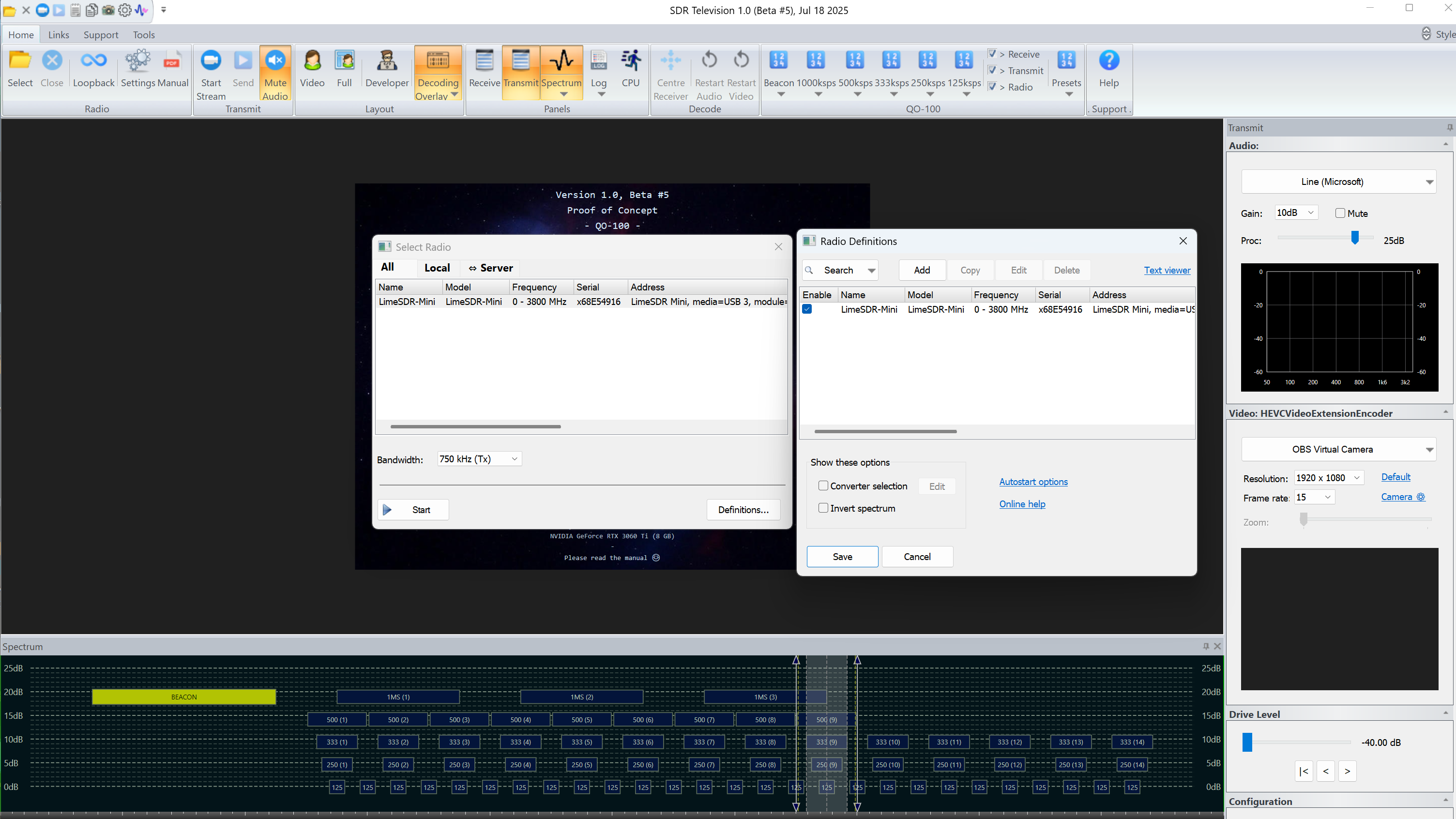

Hi - Thanks to both of you for the quick replies.
I think that SDRTelevision looks like the best route for me as it looks like the ground work is already done.
So this morning I have loaded SDRTelevision Beta#5 and got it connected to my LimeMini as below.
Next need to get to grips with it.
Thanks again
Steve
G8XPZ
Thanks again
Steve
G8XPZ

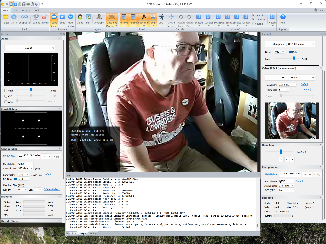

Hi
After studying SDTTelevision I have reached the point where I can see tx/RX using loopback but when I try to TX on my limeMini it fails. Can anyone see the problem please?
Steve G8XPZ
Steve G8XPZ

Re: Looking for best way to tx DATV from PC
The reason I didn't simply mention SDR Television in my earlier detailed response is because as I said at the beginning, I was not aware it worked with the Lime Mini. From the manual:
Chapter 8 Using A Radio
If you only want to receive DATV then use any SDR which receives at the required frequency. If using
a LNB then you must take the LNB offset into account.
RTL Dongle v4 – usually good for bandwidths up to 4MHz.
Airspy R2 – maximum bandwidth 10 MHz, usable 8.5 MHz.
SDRplay – maximum bandwidth 10 MHz, usable 8.5 MHz.
LibreSDR – maximum bandwidth is 18MHz over ethernet, 8MHz using USB.
For transmit, only the ADALM Pluto and LibreSDR are supported, LibreSDR is based on the Pluto
design. Other SDRs such as Lime USB and Mini will be supported later.
So as you can see, it is not yet a solution for the Lime Mini. Given the high cost of the latest Lime Mini, I can't see it being used much in future and would recoomend the Pluto or LibreSDR as a replacement. The Lime does work well with the Portsdown 4. You might be able to get it to work with SDR Angel for TX if you generate the transport stream as I described earlier.
