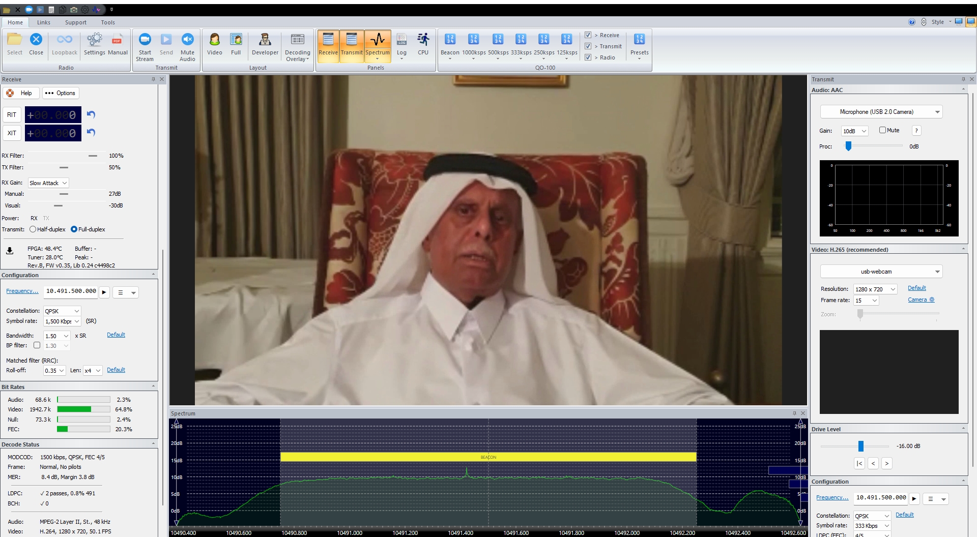

- Working
- Screenshot-2025-04-27-160519.jpg (913.65 KiB) Viewed 1671 times

I decided to run the net using SDR Television.
Using my 1.1M dish 2/3 signals OK 3/4 signals borderline.
A quick test today on my signal 2/3 H265
Picotuner Mer 7.3
SDR Television Mer 6.5
Beacon Test
Picotuner MER 8.9
SDR Television MER 8.4
I have noticed H264 signals comparison are close or sometimes SDR Television are higher.
Overall what an excellent program will be using it for the next WW NET.

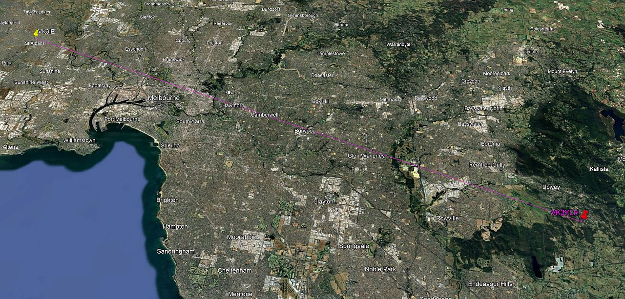

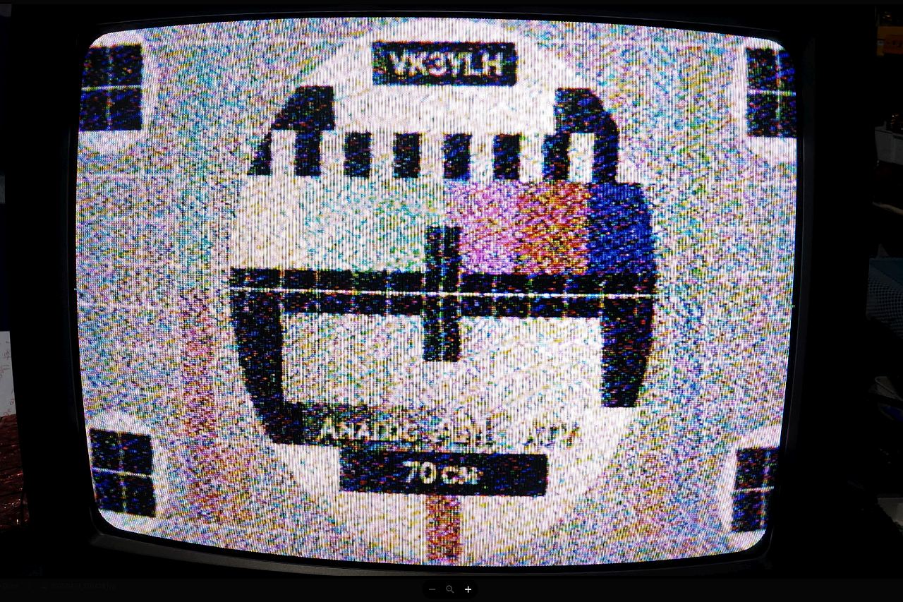

As received at my station VK3IE yesterday for VK3YLH
444 MHZ AM ATV Simplex, 55k approx
