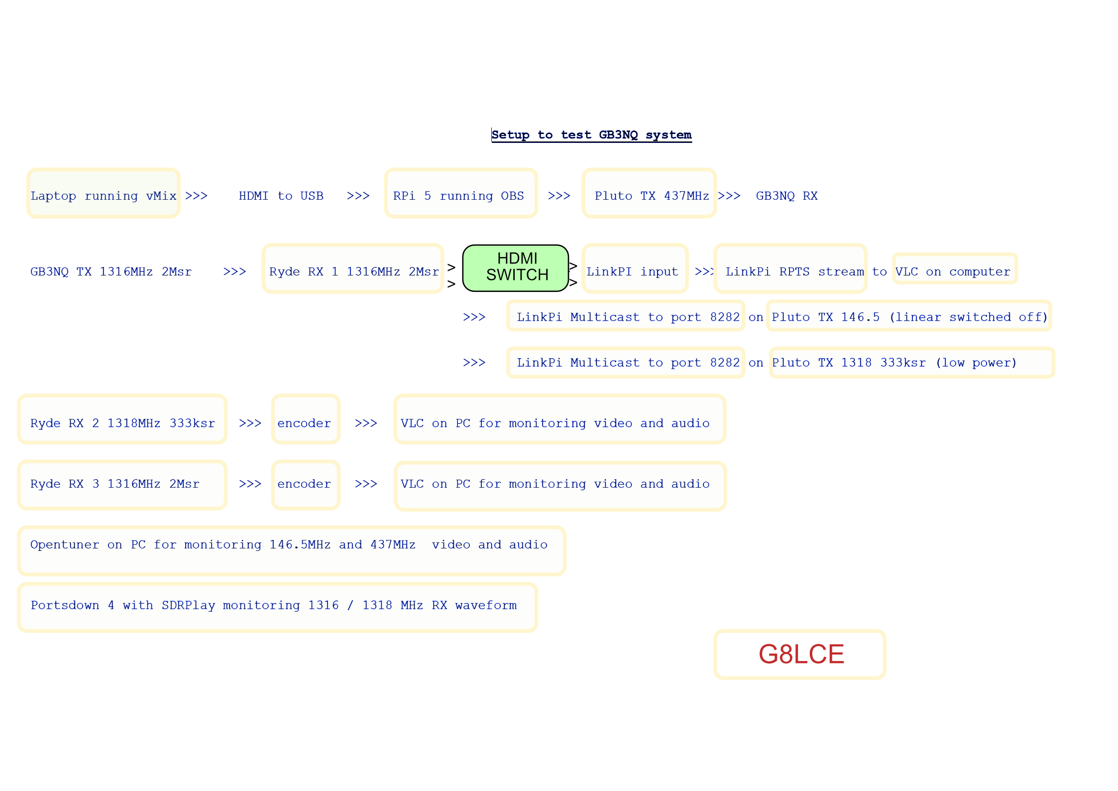

Here is the test setup. The HDMI switch is shown in the green box.
GB3NQ system test.png (216.35 KiB) Viewed 4265 times
