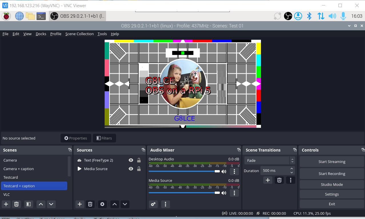

Screenshot 2024-09-22 160339.jpg (159.33 KiB) Viewed 5283 times
Martin G8LCE

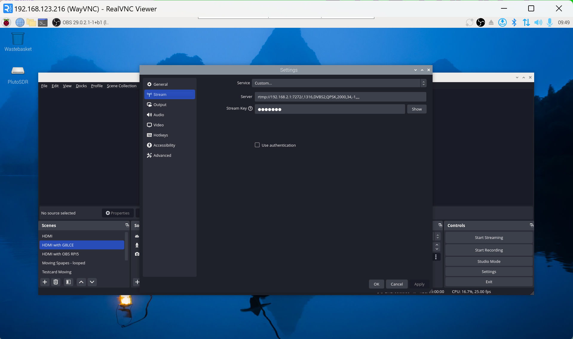

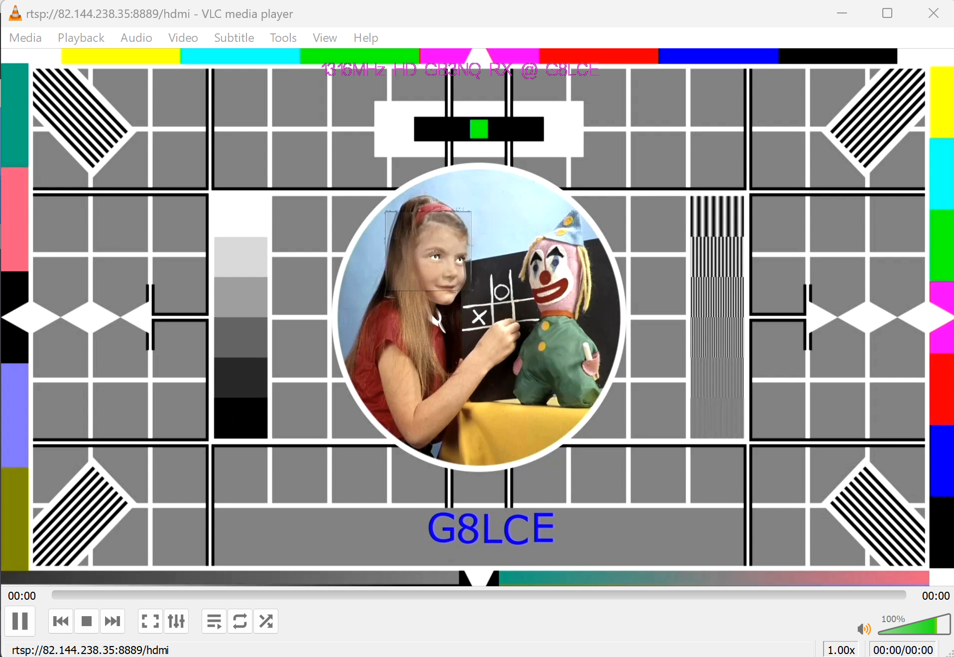

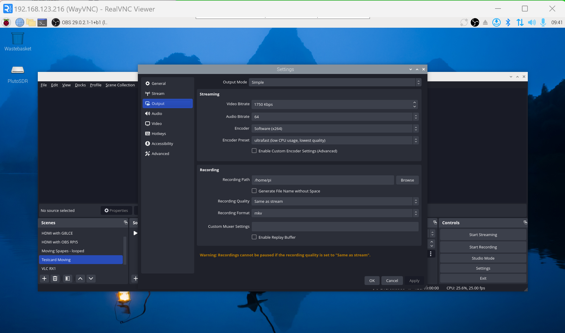

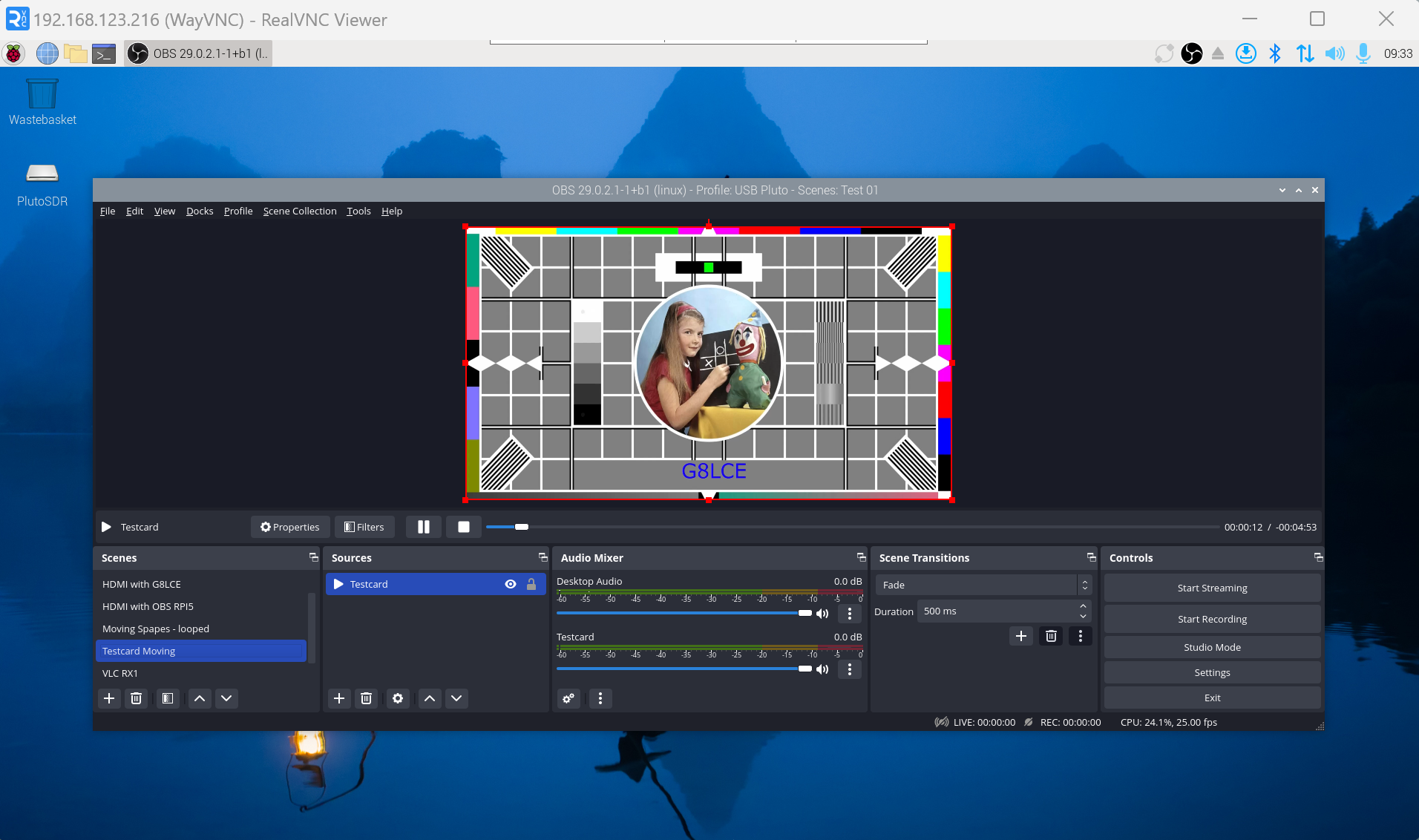

I just plugged in the Pluto to the RPi5 running OBS Studio and it works! I did load a bit into the rules dir from something I found on the Internet but I don't think I needed to.
Here are some screenshots:
Martin G8LCE
