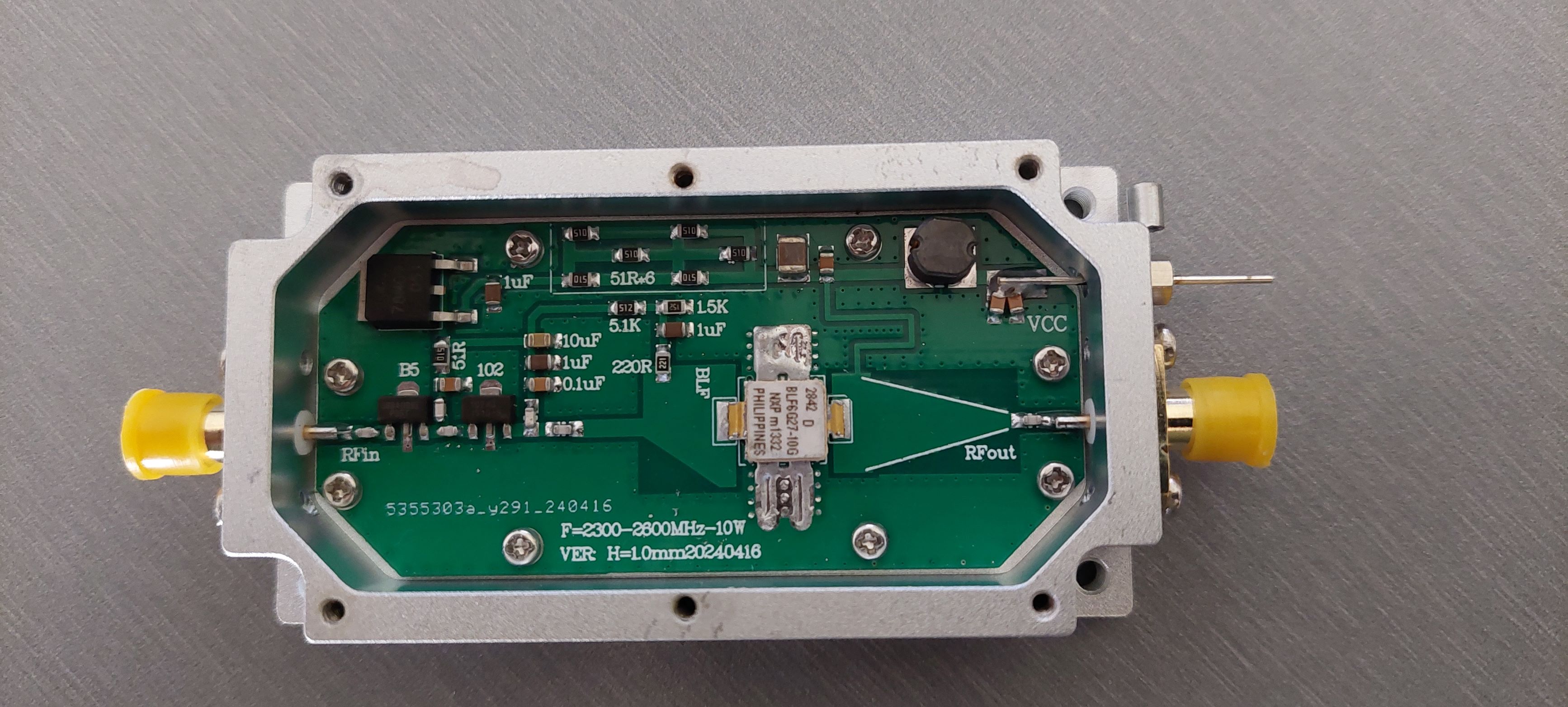

Nice little 2.4ghz PA from China on ebay.
I have only tested on FM but 5dm in produces 39.5dbm out.
approx 1.2A@26v
Wayne VK5BI

Useful little amp, I have the very similar 23cm unit that also does what it says, +40dB gain.
Could you share a link or the vendors details please?
