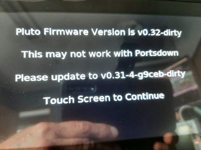

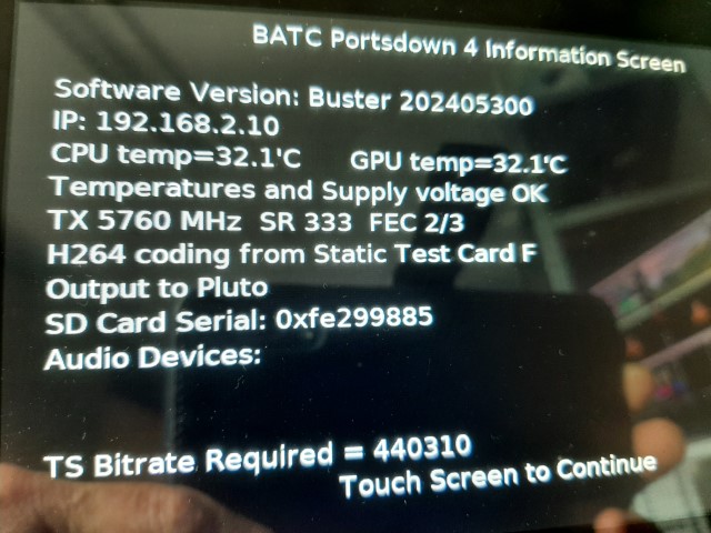

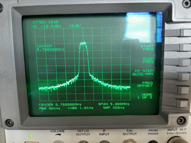

Gareth,
Some screenshots:
- Latest PD4 FW
- Pluto FW 0.32-dirty
- Pluto Pwr: 0 & Freq. 5760MHz connected to SA with an attenuator
Freddy
Some screenshots:
- Latest PD4 FW
Freddy
- PD4 info
- PD4 info (Klein).jpg (80.55 KiB) Viewed 5261 times
- Pluto FW
- Pluto FW (Klein).jpg (56.94 KiB) Viewed 5261 times
- SA view
- SA 5760MHz (Klein).jpg (76.54 KiB) Viewed 5261 times

Re: DOWNLOAD DATV-Easy v3.08
Thanks Freddy, I can also confirm that it works
No RPI-Camera or C920 on the PD4, but that is not important at the moment.
Good spot, I'll try it with my laptop now and see what happens with that.
